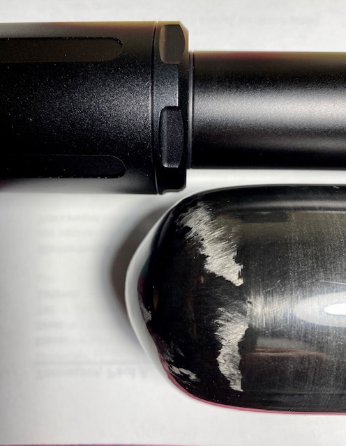

The Sumo and Tatsu are the same diameter, so if the Tatsu works, so should the Sumo.

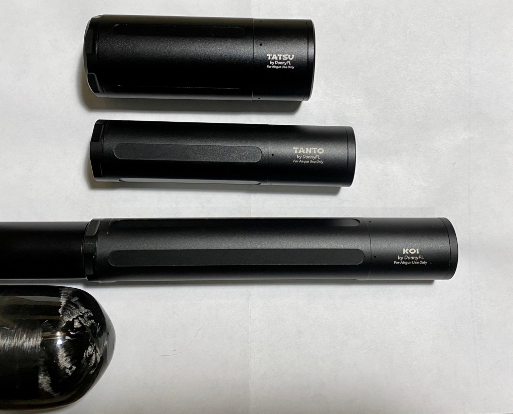

If you can, can you please post a pic of your compact with longer bottle and koi?
i was kicking around the same idea just a few days ago. I was wondering if the koi would be small enough (diameter) to clear the bottle.
TY,
Gabe
The Koi is the same diameter as the Tanto, so it will work also. The Sumo and Koi are just longer than the Tatsu and Tanto.

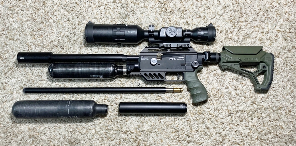

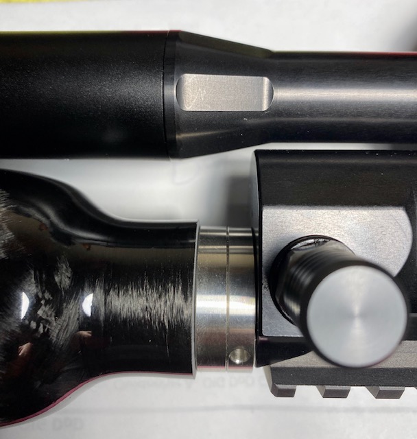

I haven't bought a carbon fiber bottle and/or owned any LDC yet, but I was trying to figure if I could get Tatsu. (I knew I wouldn't have any problem with a Tanto becuase it has a smaller diameter.) FLgunner's picture of his gun with Best Fittings 300cc bottle & Tatsu made it clear for me that I can get a Tatsu (or even Sumo) if I want when I upgrade to a carbon fiber bottle. I'm pretty sure that the spacers used on 220cc and 300cc bottles are the same size (thickness), but you can send them an email and ask to make sure. By the way, I was told by Best Fittings that the spacer can be removed using their FX Bottle Valve Installation/Removal Tool.
@FLgunner...thank you for the pictures.

Contacted Best fittings for more details. I plan to remove the spacer or replace with a thinner one. I don't see why the spacer in my case is needed.
Will keep you posted
More from Best fittings:
"I have updated the dimensions on the website to be accurate.
The lengths are approximate as the cylinders are carbon fiber and may vary slightly.
220cc with FX Valve - Approx 210mm long
300cc with FX Valve - Approx 260mm long
Yes you can remove the spacer if you want to, you would just need this spanner to enable removal of the valve:
https://www.bestfittings.co.uk/shop/fill-probes-adaptors/buddy-bottles-valves/fx-buddy-bottle-valve-installation-removal-tool/
The Spacer is 6mm thick.
We fitted these originally because of the small mounting rail as found underneath the bottles on the FX Impact guns."
