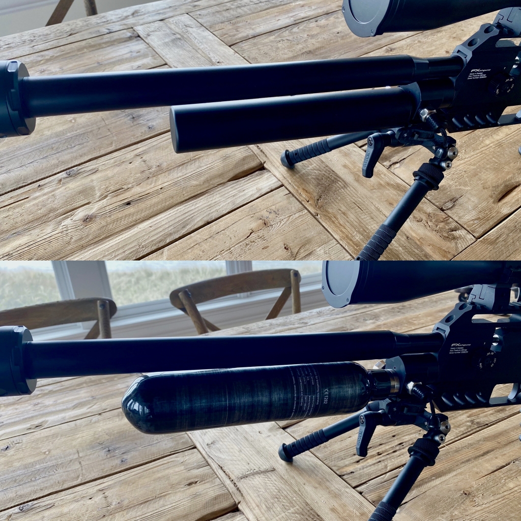

Before and After....
That looks awesome, but I have a .22 compact and wonder if the 300cc tank will fit on it. Can you please kindly measure and share with us the total length of the whole fitting from the bottle adapter to the end of the tank? Thank you in advance. 😁

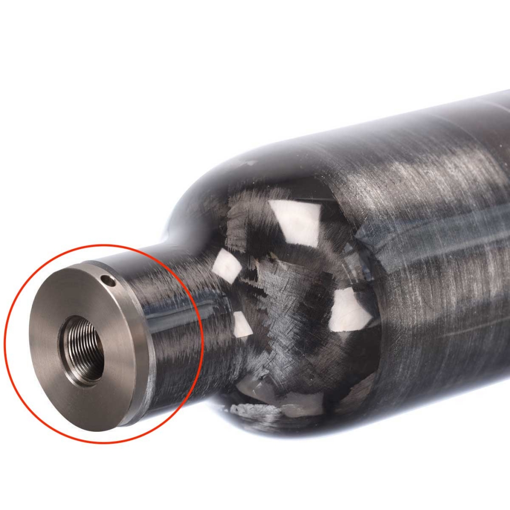

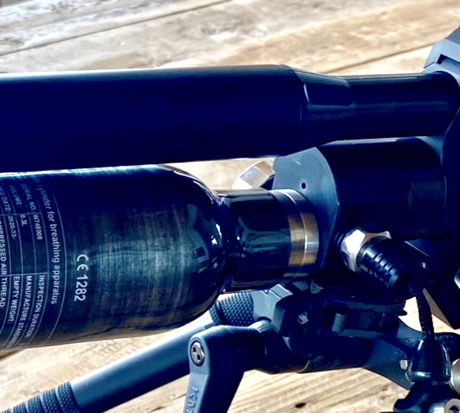

The bottle measures 10 3/8" overall and with the bottle adapter it's 12" overall. You should already have the bottle adapter on the gun as standard. Alarme realize this is the .25 Cal and my barrel is about 4" longer that the .22 barrel. Right now in this pic the end of the bottle to the suppressor is 2.5" so there may be a conflict with your suppressor in less you have a small diameter suppressor. This is a Donny FL Ronin @ 2" in diameter

That's wonderful, Jeff. Now I think I want to get a 300cc bottle to help increase shot counts. I will probably acquire a DonnyFL Tanto or a Huggett Belita - both have 1.22" Dia. I believe I will get a good clearance with either of those. Thank you again very much.
