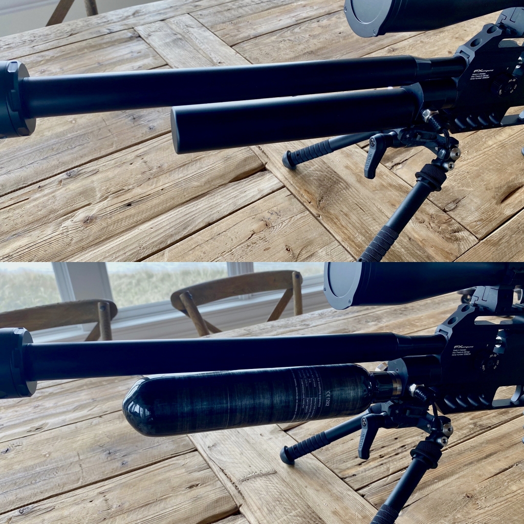

I just got my Best Fittings CF 300cc tank. Got in one day from the UK to the states! I was amazed. It fits perfectly and yes, the FX valve allows you to remove bottle charged. As to shot count, I have the .25CAL Compact and with the stock 170cc Aluminum bottle filled to 230 bar I got about 13 -15 shots before she fell off the regulator at 150 bar. I now get around 30-32 per fill of the 300cc bottle. Thats also shooting an average of 845 FPS. Hope this information is useful. Again, the link to the bottle is below.

Please pics
Before and After....
