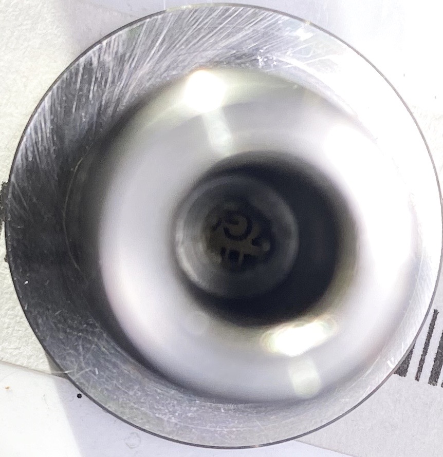

Yea, well update to the update... It didn't fix mine either! It held air over night, but when I put it back on the DTC last night and tried to remove it again, all the air leaked back out! I was able to remove the valve and cleaned it up, but I noticed a lot of what appears to be chipped metal around the opening where the poppet stems goes through, and this is the surface the poppet needs to seal against.
This isn't the greatest picture because it's taken with my phone and it's almost impossible to get it to focus on the bottom of the inside of the valve. In any event, Richard from Best Fittings did respond and we have been swapping e-mails and pictures. He is looking into the cause and a solution, but said he would be sending me a new valve next week. Hopefully, they will get it resolved and won't have these problems in the future. I have to wonder if they may have just received a bad batch of valves.

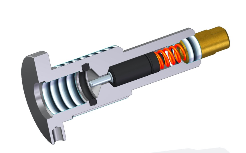

They are sending me a new valve this week. They told me the poppet material is HDPE, I'm not exactly sure what that is, but they said they chose that material because it provided a better seal. You shouldn't get a bang or launch the tank unless the valve is failing after you have already loosened it to the point the threads will no longer hold. When I remove mine all the air rushes out before I can ever get it more than halfway off the rifle. This is what the valve looks like, courtesy of Best Fittings.

HDPE is High Density Polyethylene and is a plastic that is commonly used for milk bottles, jugs, detergents, etc. It seems kind of strange that that material would be used in a valve fitting and could be the reason your bottle continues to leak when removed, @FLgunner. It may not provide a complete seal as other more appropriate materials would. We will have to wait and see what BF has to say about a fix and/or replacement. Vetmx is right, this is a high pressure fitting and the problem needs to be addressed by them, not a DIY fix.
