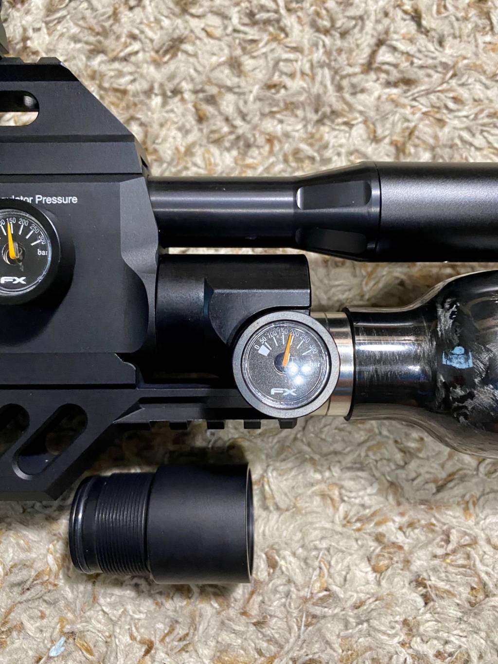

The current shroud that comes on the DTC barrel won't allow it, not enough clearance. I have seen videos of DTC's with short barrels that are the same diameter as the 500mm barrels, so that may be something coming that will allow the installation of the PP on a DTC.
Here's a picture that may better illustrate the problem. The PP in installed between the Breech Block and the Tank Drop-down Block. You can see by the length that it would not allow the barrel to seat into the Breech.

Yes, that's what I suspected was going to be the case. I have seen videos of the Dream-Tac Compact with the thinner shrouded barrel. Unfortunately, for those of us who have already paid over a $1K for the rifle, I don't really want to pay another $300 - $400 for a barrel kit just to use a $30 Power Plenum. I do have the longer 500mm barrel and can use the Power Plenum with it, but it looks like my DTC will remain Power Plenum-less! They really need to make a replacement shroud with a longer lead-in to accommodate the Power Plenum and then sell that to those of us with the old style barrel at a deeply discounted price!
Or get busy on a lathe. That’s what I did. The gun has been fantastic but if it’s any comfort, the added plenum is not a game changer with such short barrels. You aren’t missing much. Wanting what you can’t have is more the issue I think.
Yea, well some of us don't have have the tools and skills that others here do! LOL! So wanting what I can't have applies more to those tools and skills than the power plenum! I have added one to my Dream Classic, and you're right, it really didn't make all that much of a difference. I see more of an increase just swapping the 320mm barrel to the 500mm barrel! So, yea, I'm pretty much happy with what it is and all it is! It works for me!
