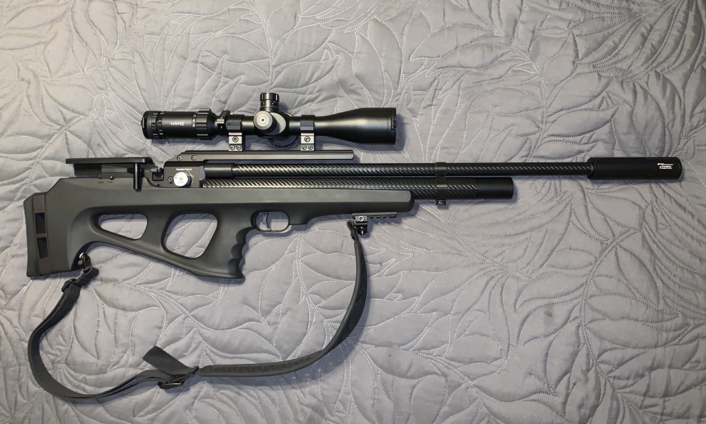

The 600mm on the the DreamPup .22 adds power with less regulator pressure and is working out marvelously for mine. With pellets and slugs using the 600mm slug liner.
1570634814_20874280135d9dfc3e2eedc0.00522151_92F82E0D-DF31-430A-A1CC-73DE309511F9.jpeg
