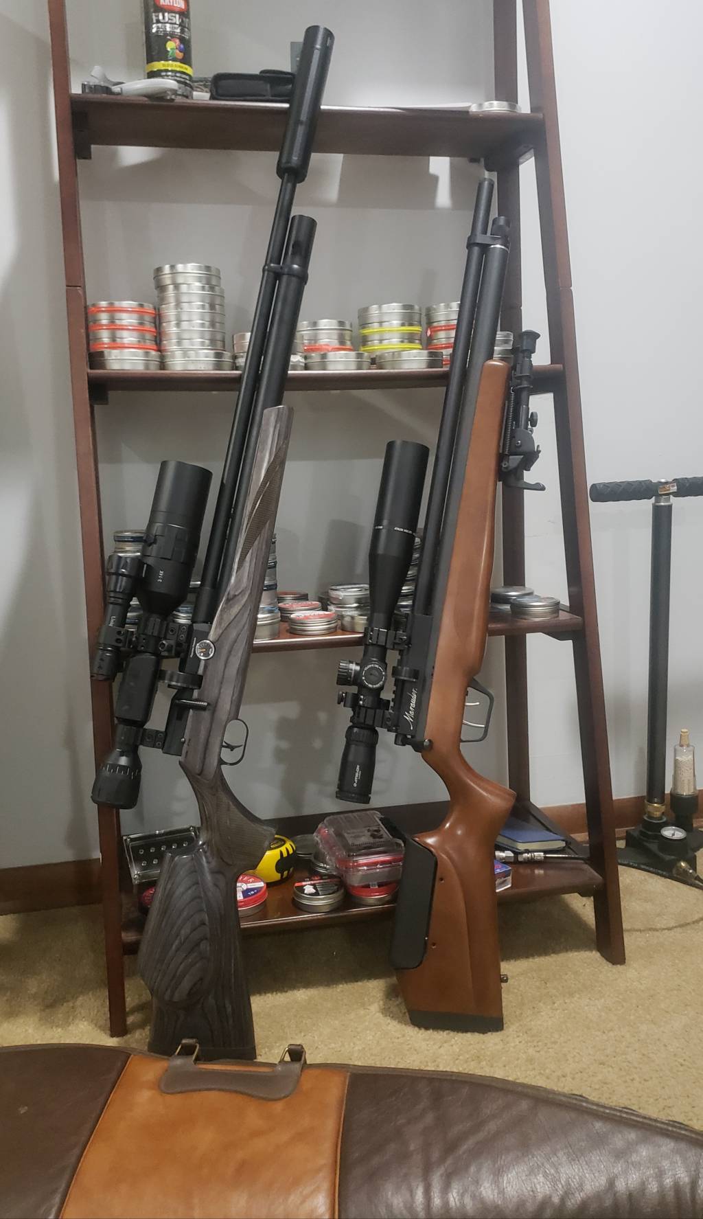

I have a Dreamline Classic (600mm barrel) in .25 cal. Using a phone dB reader (no idea how accurate it is lol) the gun registers 107dB without a moderator but only 95 dB with a DonnyFL Shogun installed. That may not seem like a big difference but in reality it's huuuge. At 95dB it is very quiet.
Gun is running 25.39gr Kings at 910fps for 47ftlbs.
I also have a 22 Marauder. The Marauder is the gold standard for quiet and is definitely quieter than the Dreamline BUT it is also only putting out about half the energy of the Dreamline. I've shot both guns in neighborhoods with relatively close neighbors (safely of course) without anyone being the wiser.
My recommendation is to buy the Dreamline, skip the add on cost for the factory DonnyFL, and purchase the Shogun separately (.30 cal for a .25!)
