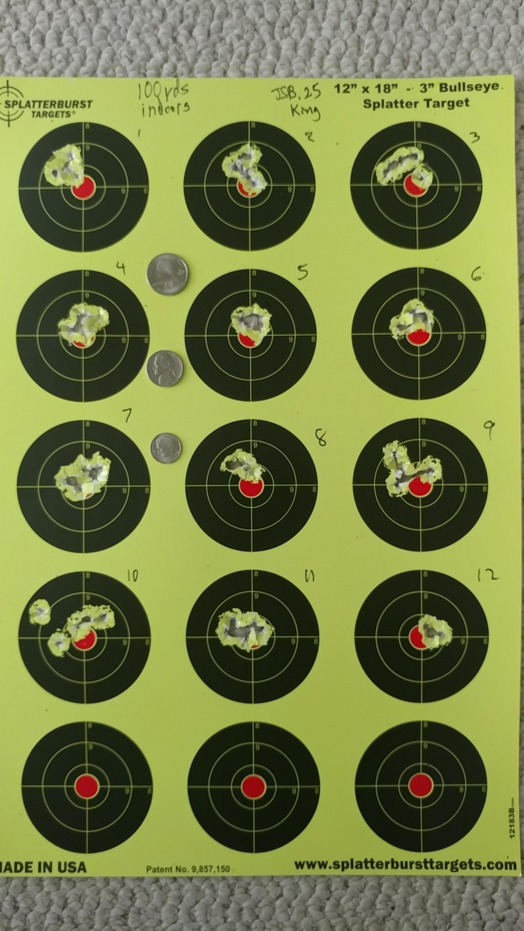

Thanks for your input and experiences. Yes, it will be interesting to see how I stack up against a gun vise? Kinda makes me nervous. Lol.
It appears that I may have erroneously assumed that absolutely no wind was most favorable. But I do still believe(and the results support) that shooting in the warehouse, out of a gun vise, with the same aimpoint, produced tighter(and more closer to the bull) groups than shooting the same setup at my outdoor range with a variable 0 to 2 mph wind. I think I did succeed in eliminating variable outdoor effects(wind, temps, sunlight, bugs?, etc.) on 100yd group sizing, with my gun setup, shot out of a vise with same aimpoint.
Very interesting about a slight(and probably constant) wind being most favorable for accuracy.
