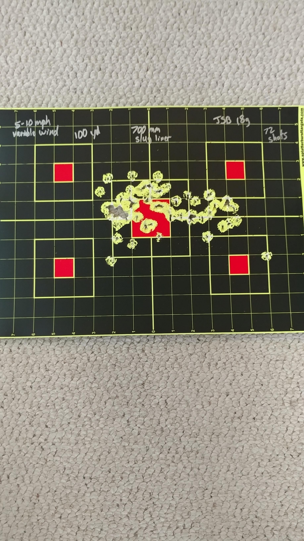

I decided to shoot 100 yards OUTDOORS today in the WIND, using the new "low power" setup(see previous post-Part 3) on my Crown Continuum with 700mm slug liner to see the effects it would have on a JSB 18g at approximately 874fps. The wind was variable 5 to 10mph coming mostly from behind me(toward the target), but gusting back and forth sometimes from the right and sometimes from from the left. I set up stakes with flagging tape every 10 yards out to the 100 yard target.
I decided to shoot 4 magazines(72 shots) of JSB 18g(876 fps) onto 1 target using the same hold point(center of the target). This is the resulting group:

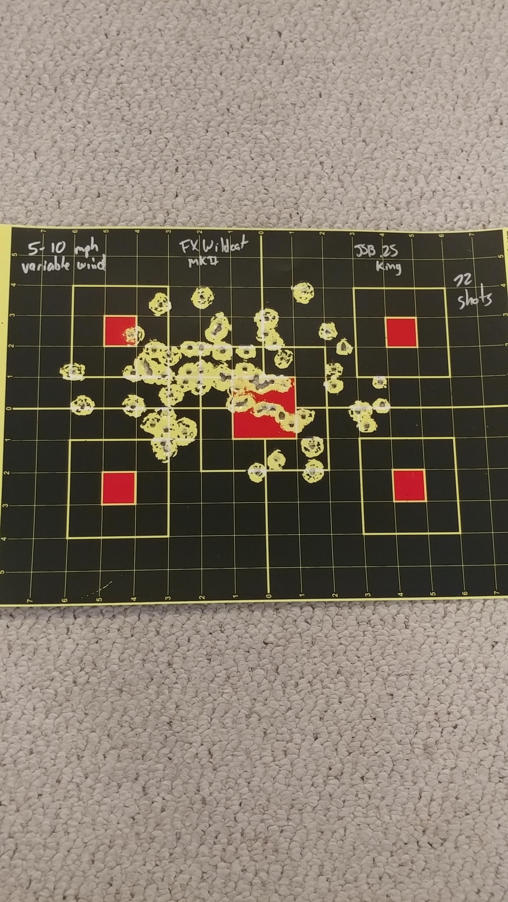

I then decided to see what effect this wind would have on a .25 JSB King(ave. 890fps). So I switched to my .25 FX Wildcat, which was zeroed at 100 yards and used the same procedure(72 shots) to shoot this group:

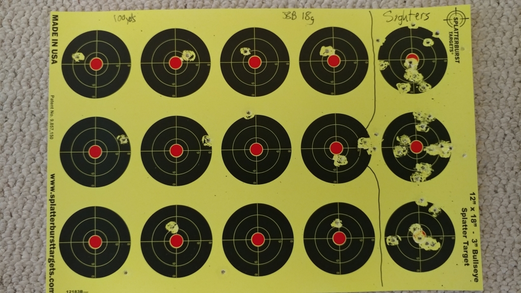

Interesting that the heavier .25 Kings at 890fps seemed to get blown around about the same? I then decided to switch back to the Crown with the JSB 18g and practice shooting some targets "for score" in the wind, trying to watch flags and learn when to shoot. I loaded up a mag straight out of the tin(like I always do). I decided to shoot holdover/hold-off since I am familiar with that(from hunting). Plus it is faster than clicking and the wind was changing directions so quickly. This was my first "scoring target"(I know they aren't real tournament targets):
Encouraged by this 1st target, I thought "Well that's not TOO bad. I'll just clean this up a bit, take a few more sighters, watch the flags a little closer, keep my sighters OFF the scoring targets, and get ALL the shots near/in the red on this next target".
Wrong. WRONG. Next target please:
Ugh, worse. I decided that I had been shooting a long time and was getting tired, so I decided to take a break. Then the wind started to lay down(ruining the test), and one beer led to another and I figured it was time to call it a day.

Is the barrel of the Wildcat smooth twist? (only on the muzzle end) and the Crown is STX. Even though you were shooting pellets out of a slug liner. Maybe the stx liner is that much better? The designs are apparently pretty close between FX slug liners and pellet liners. So much so that the newest .25 "Superior" barrel design is marketed as the one stop solution for pellets and light slugs.
The 18.1gn JSB .22 is a really nice pellet design. Almost the same B.C. as the 25.4gn .25 pellet. And so, almost the same possible accuracy in wind. Cheaper and use less air.
The B.C. is .035 for the .22 versus .038 for the .25.
You have to be able to make it to at least 56 fpe with the JSB 33.4 Heavy MK2 at a B.C. of .046 to see a big advantage for the .25. Those start to get expensive at $0.063 per shot versus $0.038 for the .22 heavies.

Thanks for your question. It was just an offhand comment about how it is interesting(maybe counter-intuitive to some) that one HEAVIER projectile(.25 JSB King 25g) and one LIGHTER projectile(.22 JSB 18g) fired at roughly the same speed, would be effected by the wind about the same amount. But of course, it is explained by their ballistic coefficients being similar. Thanks for making that point clear
Ghostranger, the BC of JSB 18 vs JSB King is pretty same. Why whould you expect less wind drift from the latter one? 100 yards in wind is a task for JSB .30 or slugs.
True, in my testing the BCs of those two pellets are about identical. But to say 100 yards on the wind is a task for .30 isn’t a reflection of your statement about BCs. The .30 Exact has a BC only slightly better than the .22 JSB 18.1 or the .25 JSB King 25.4. Maybe about 10% better. Not a great amount. So if the .30 is drifting 9 inches the other two will drift about 10 inches. Better, but nothing to write home about. Slugs however, are a different story...
