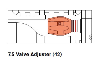

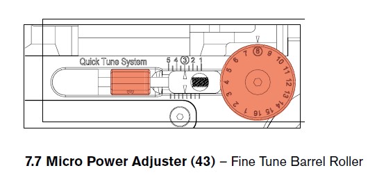

The Crown has 4 things to adjust. These are (1) the Power Wheel, (2) The Transfer Port, (3) the Regulator pressure and (4) the Hammer Spring. Three of the3se can be adjusted without any disassembly of the gun. The Hammer Spring pre-load require the removal of the stock, which is a PITA, since you first have to remove the Power Wheel (DONT LOSE THE LITTLE BALL BEARING!) and the Safety.
The Impact has (1) The Power/Macro Wheel, (2) the Micro Wheel (AKA Hammer Spring Preload) (3) the Second Regulator, (4) the 1st Regulator, (5) The Valve adjuster. All of these are accessible without any disassembly, and, in my experience, give you a finer degree of control over the power levels. This is especially true of the Valve adjuster when compared to the Transfer Port adjustment on the Crown. The3 Impact Micro wheel is also MUCH easier to adjust, and much more repeatable due to the way it is constricted and marked than the Crown Hammer Spring.
Bottom line, theCrown may be "easier" but that's because it simply has less things to adjust.
Like I said, love them both.

The Impact has a micro-adjuster with the power wheel for fine tuning, on the Crown you have to remove the stock and use an allen wrench. Impacts also have a valve adjuster.
View attachment 284145View attachment 284146
Thank you, H69. I appreciate it. I needed clarification by you and ChriSiS regarding the micro power adjuster vs. the Crown's setup. I have neither gun, but I can quickly see the advantages (ease and precision) of the Impact's configuration. The reason I will go for the Crown is because it is easier to work with overall, and not just in regards to tuning, if I understand what I have watched on YouTube from Dubber, etc. I am simply not a handy guy, and I am on in years a bit. S7
On the Impact the micro-adjuster is a thumb wheel that's accessible without removing the stock. On the Crown, no thumb wheel, you need to remove the stock and use a small allen wrench instead. Bear in mind the micro-adjuster is for small adjustments. I've been shooting my Crown for years and never touched the micro-adjustment; the gun is very accurate.
