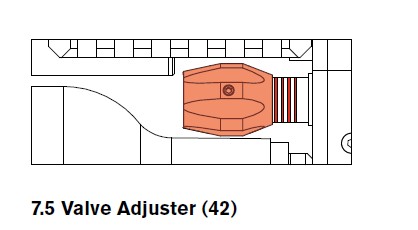

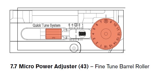

The Crown has 4 things to adjust. These are (1) the Power Wheel, (2) The Transfer Port, (3) the Regulator pressure and (4) the Hammer Spring. Three of the3se can be adjusted without any disassembly of the gun. The Hammer Spring pre-load require the removal of the stock, which is a PITA, since you first have to remove the Power Wheel (DONT LOSE THE LITTLE BALL BEARING!) and the Safety.
The Impact has (1) The Power/Macro Wheel, (2) the Micro Wheel (AKA Hammer Spring Preload) (3) the Second Regulator, (4) the 1st Regulator, (5) The Valve adjuster. All of these are accessible without any disassembly, and, in my experience, give you a finer degree of control over the power levels. This is especially true of the Valve adjuster when compared to the Transfer Port adjustment on the Crown. The3 Impact Micro wheel is also MUCH easier to adjust, and much more repeatable due to the way it is constricted and marked than the Crown Hammer Spring.
Bottom line, theCrown may be "easier" but that's because it simply has less things to adjust.
Like I said, love them both.

The Impact has a micro-adjuster with the power wheel for fine tuning, on the Crown you have to remove the stock and use an allen wrench. Impacts also have a valve adjuster.
