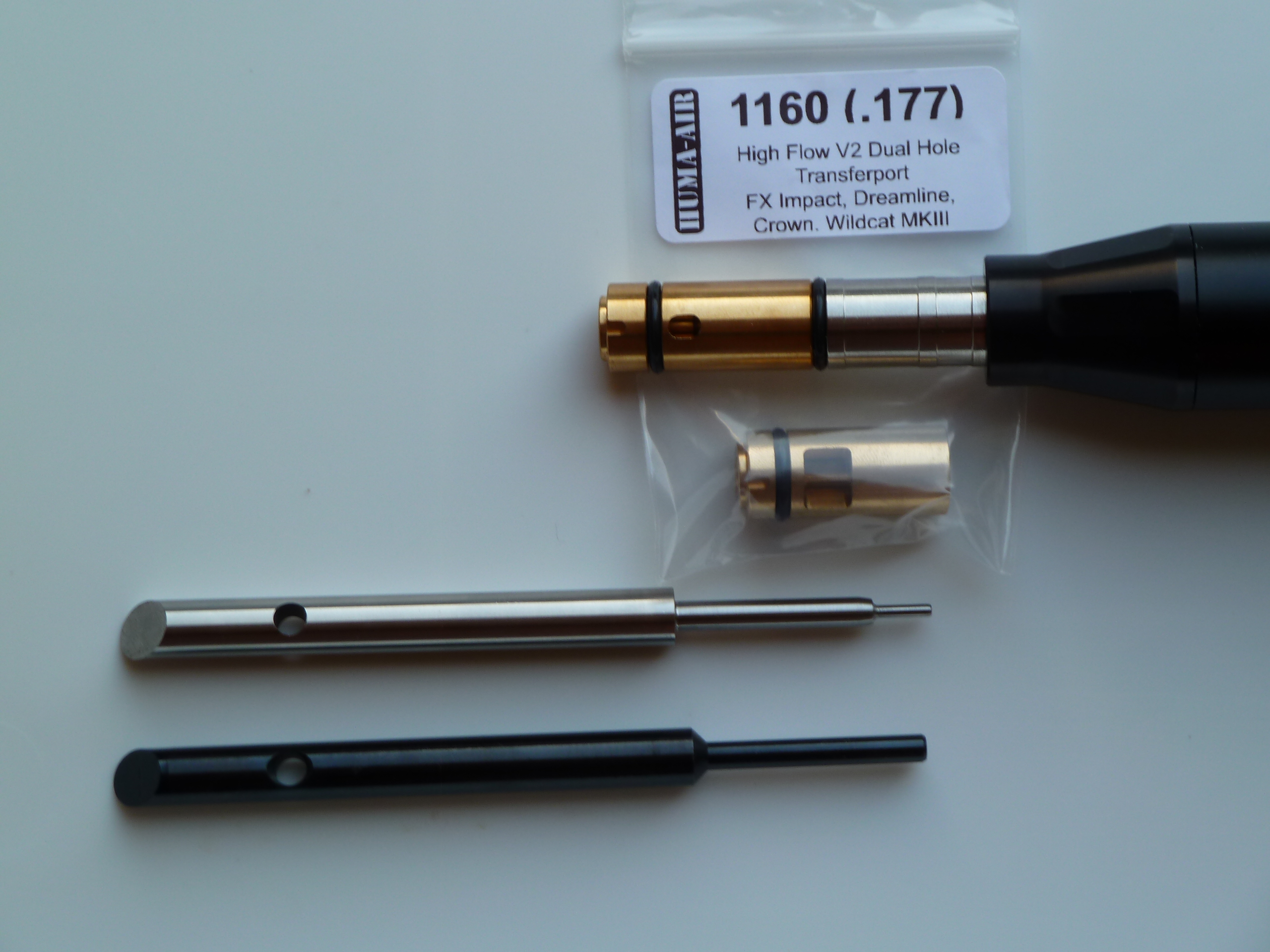

April last year bought a laminate .22 Crown MK2 with a 600mm barrel, factory set at 95bar (for 18grains shooting).
Somewhat later purchased a .177 super light kit with superior in 600mm plus a Huma .177 pin probe, and the two available versions of the JSB .177 slugs, which were subsequently shot on that same 95 bar factory setting (and using a Huma pin probe).
  • The lighter 4,51mm JSB slugs (10,03grains) performed rather poorly, at whatever hammer spring setting. Tried velocities between 275m/s and 295m/s (900fps – 965fps) but always with disappointing grouping results (at target distances of 50m/55yards, at 65m/70yards and at 75m/80yards)
  • However, the heavier 4,52mm JSB slugs (13,43grains) shot at around 285m/s (935fps) surprisingly did quite well, with groups well under an inch at 75m target distance and even much tighter at shorter target distances (outdoor conditions no wind)
At the moment i m again shooting the .22 barrel kit, but as soon as my ordered .177 H&N slugs and .177 JSB Redesigned come in, i ll give them a go.
