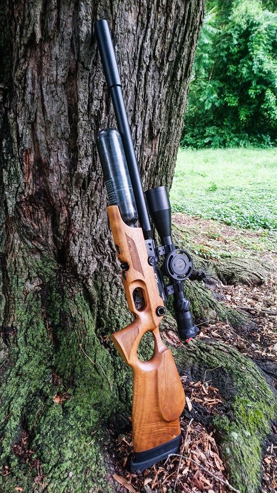

I've had both, and the impact was NOT for me. I dont like the balance. It does not point naturally. the trigger is not as adjusteable as my crown. The loading port is in an awkwards position. And, it flat out, just felt weird in my hands. the performance and power are hard to match in their respective calibers.
But the crown just handles sooooo much nicer. I've got a walnut stock with my own finish. Wood is quite easy to get dings and scrapes out of. And the finish I used is suuuuuper easy to maintain/touch up.
I also like to carry it one handed thru the woods. And is very comfortable to do so. The barrel is very short, and still shoots 16gr pellets with pinpoint accuracy @960fps
