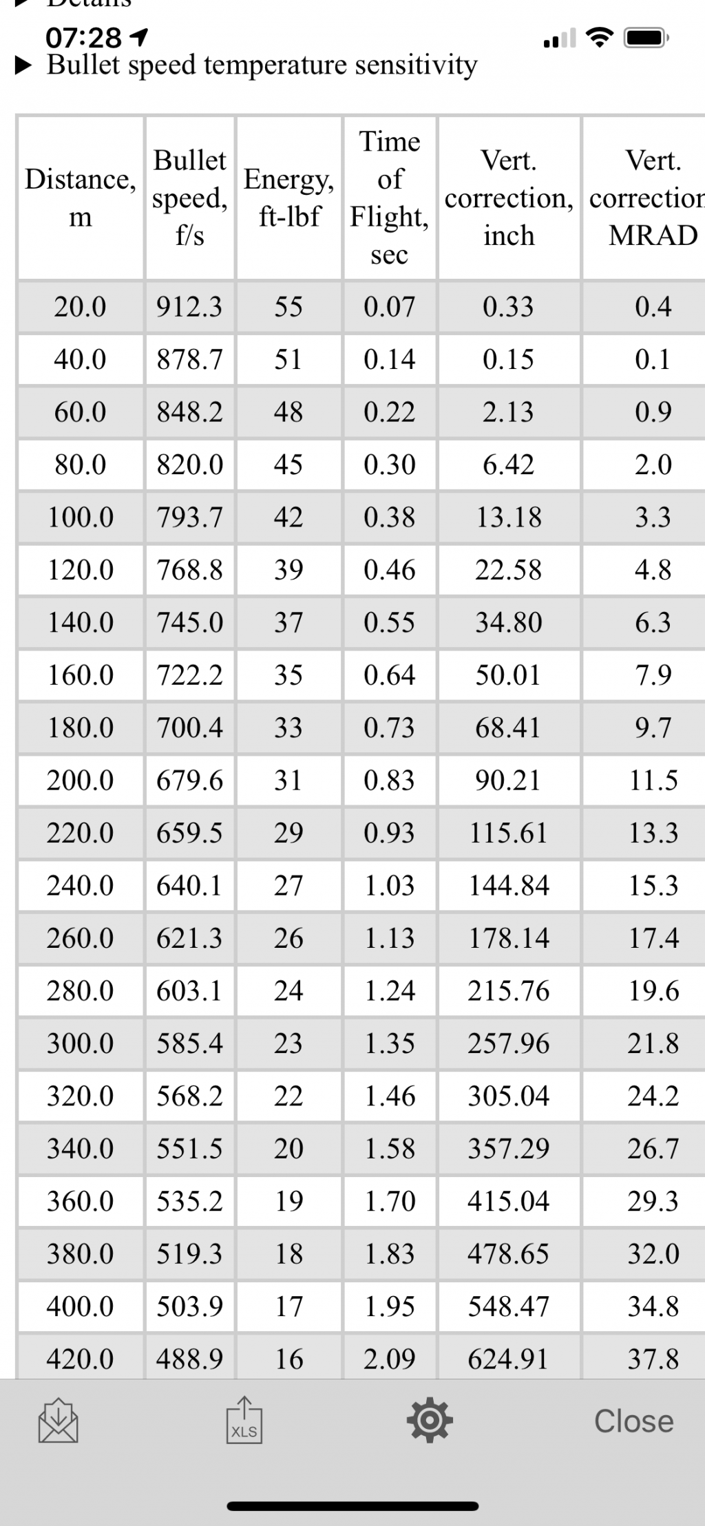

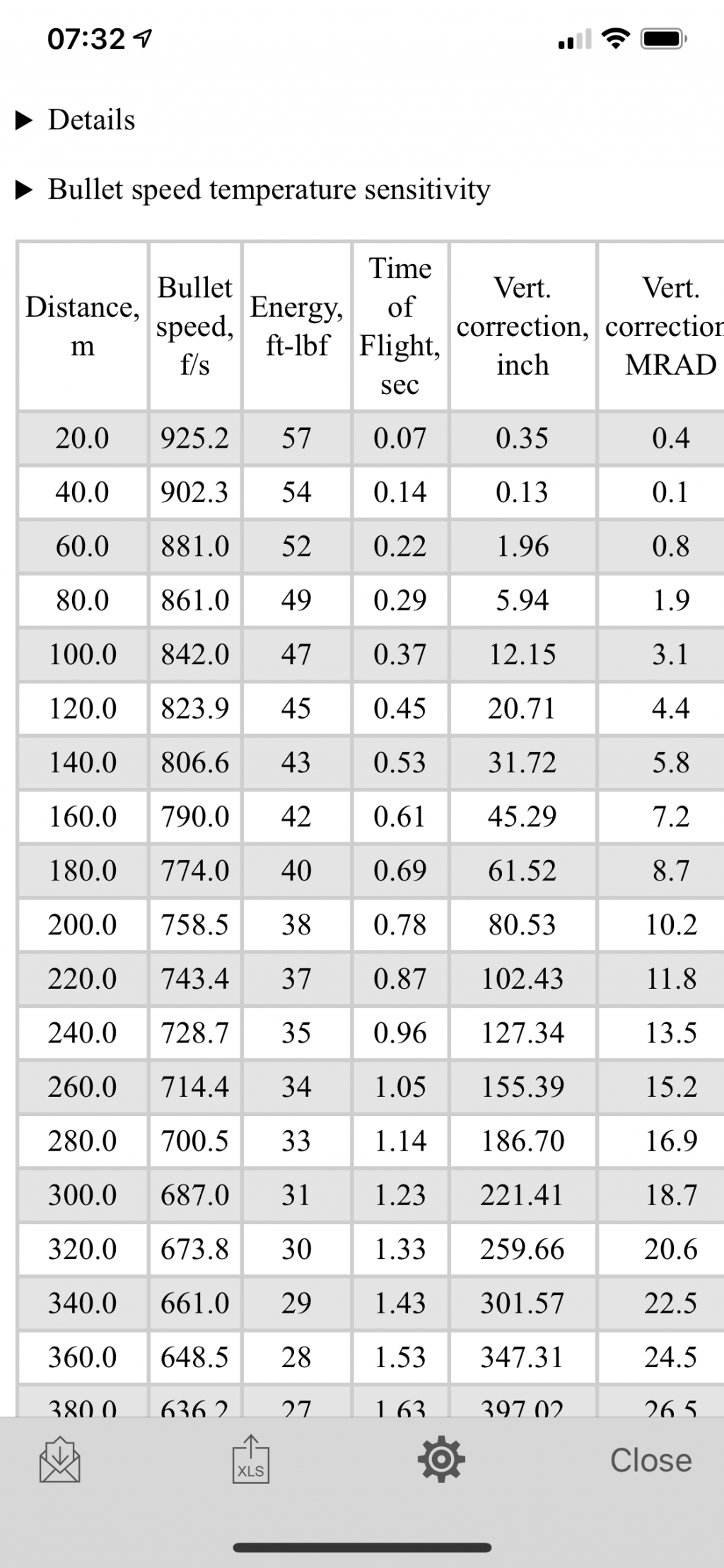

BC doesn't seem to make much difference for a given speed according to Strelok. For 950fps, here's what a static BC of 0.09 is compared with 0.14..
