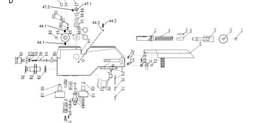

In that case, yes you could remove the valve seat from the back side of the action after removing the hammer.
You will need a long and thin rod or other pusher, preferably made of a non-marring material (plastic, or metal with a little piece of silicone tubing over the end). Once again, if like the Boss, the back side of the valve seat should just slightly impinge into the hole the valve itself would stick through - giving you just a little lip to catch and push it forward.
This won't take much force at all - the valve seat is held into its hole in the block just by the interference fit of the (lubricated) o-ring around its exterior. If force seems to be needed, you are doing something wrong!
