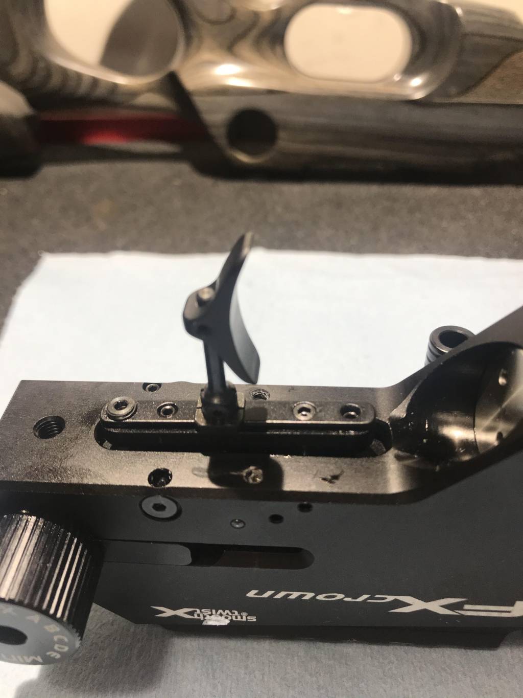

So Glen - I see on your trigger that you moved it towards the back from its original set up, was there an advantage to this and or what was your reason ??!!

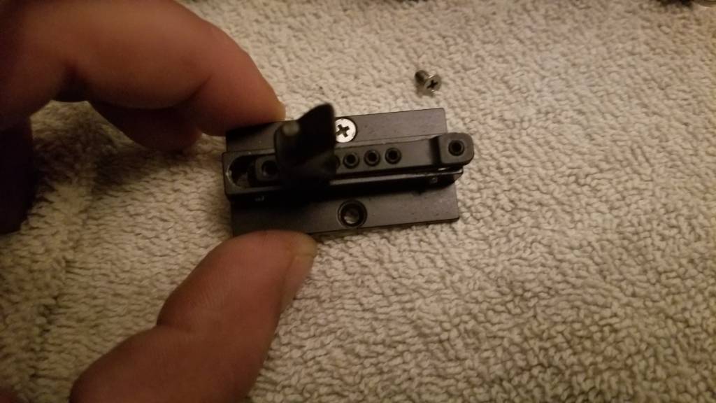

I have dry fitted the trigger and see how to go forward with the upgrade - just waiting for the spring and screws, they should be here by weeks end. Next will be to figure out what screw doors what !!!!
thanks for the help !!
The three middle screws all make adjustments to the second stage to my understanding. Will take some fiddling to get it how you want it.
There's no one simple answer to my knowledge.

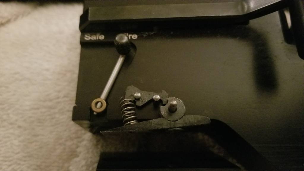

Here is a great shot of the Boss with its safety! Note the screw as well the handle selection set up.
Crown is total different. My Continuum anyways ! No screw on selector shaft.![]()

I think I know how to look and see the alignment of the adjustments to the safety in the Crown .
Im not sure just now and will need to go back and check it all. I’m thinking the safety location, although the same in the FX block, aligns differently when dealing with the match trigger. I just will need some time to get on it, and time is my enemy these days. But I’ll get back to it and do an update.
