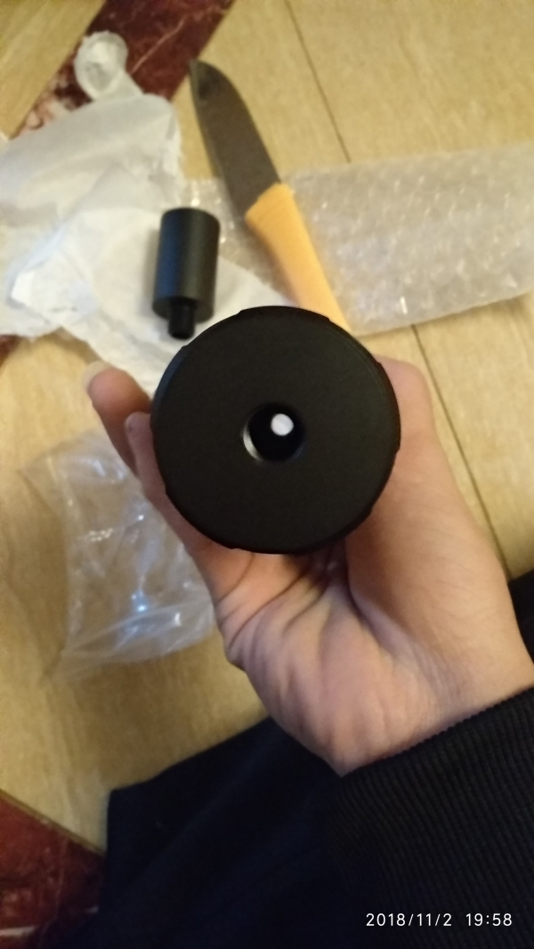

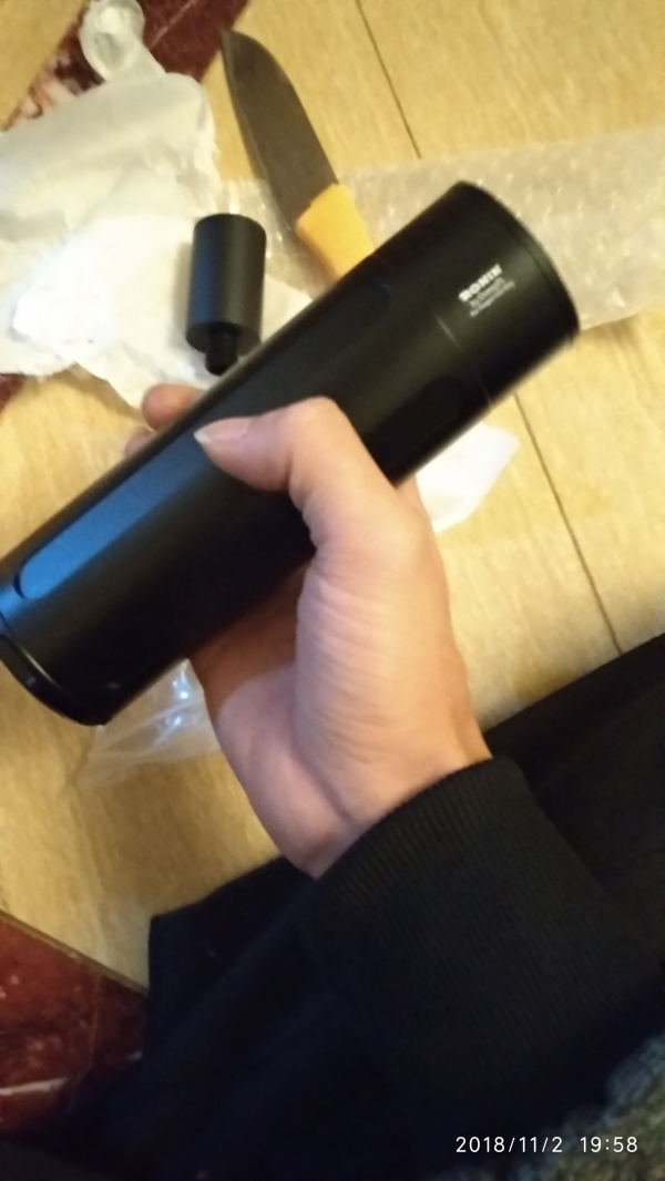

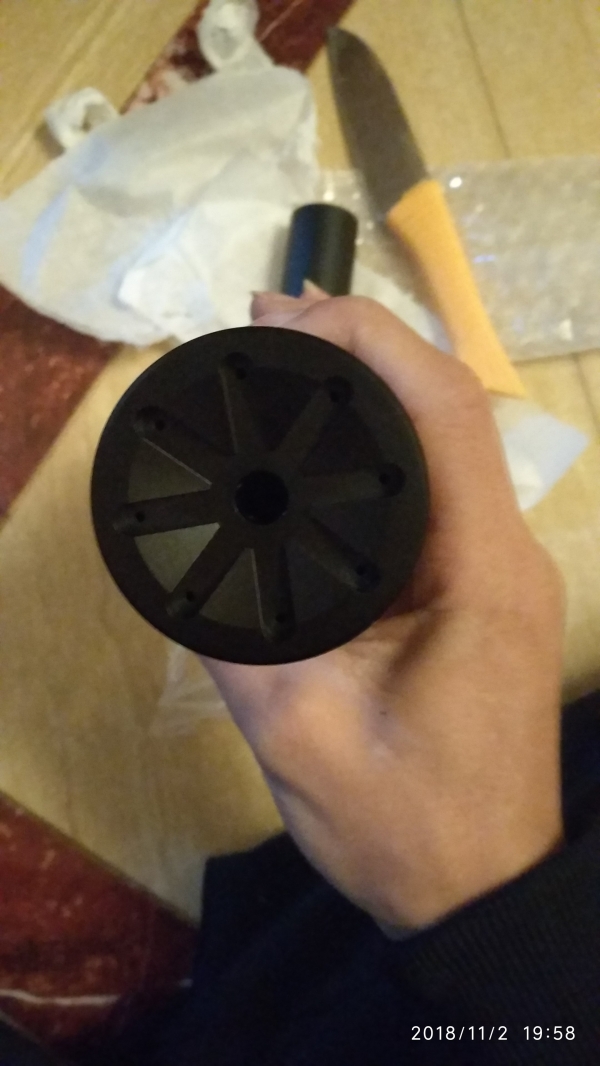

I have a new Crown and I made a silencer for it DonnyFL will not sell his silencers outside the USA, but he will sell the adapters. On the Crown the silencer mounts to the shroud. His adapte,r shroud to male 1/2-20TPI works great. My silencer weighs 238 grams. it works really well, it changed the POI at 15 meters down and right 3.5 CM, but with no loss of accuracy. I do NOT recommend an extra support. It isn't necessary.

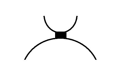

There is no reason to leave the barrel shroud unsupported. Accuracy will not change by adding the spacer. This is not the same as guns with solid steel barrels. There is nothing to be gained by leaving the barrel shroud unsupported on a Crown and nothing to lose by supporting it.

I have tested it. Why do you think I would say so without testing? Even with an Impact if you rest on the barrel you can move the point of poi up 18 inches at 50 yards. Do as you like with your gun but logic dictates that a straight barrel is ideal and no harm will come by keeping it straight. Most people don't take crowns hunting for fear of hitting the barrel on something. This is not about ego, it's about an option to support the barrel that can not do any harm.

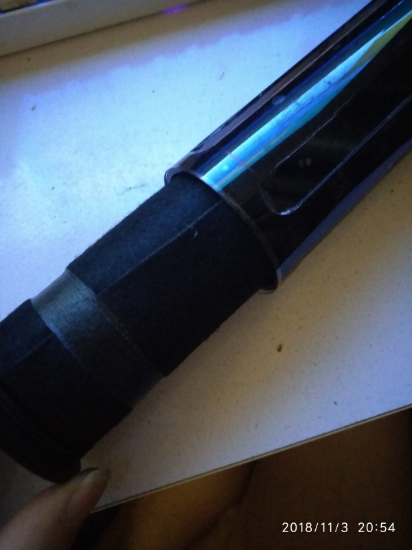

Well, first you did not state you tested this. So, in light of your testing, how much pressure does your support apply to the barrel. Please include a photo. I have a machine shop and I can easily make one. You are correct about traipsing through the woods with a Crown. It just isn't on, it is a bench gun and even at that, adding an 8 inch silencer does not make it less awkward.
My brother-in-law owns a crown. The spacer we added doesn't apply any pressure, it only stops the sag and goes near the end of the bottle. He's the last person who should own a crown, he bumps it on everything.
