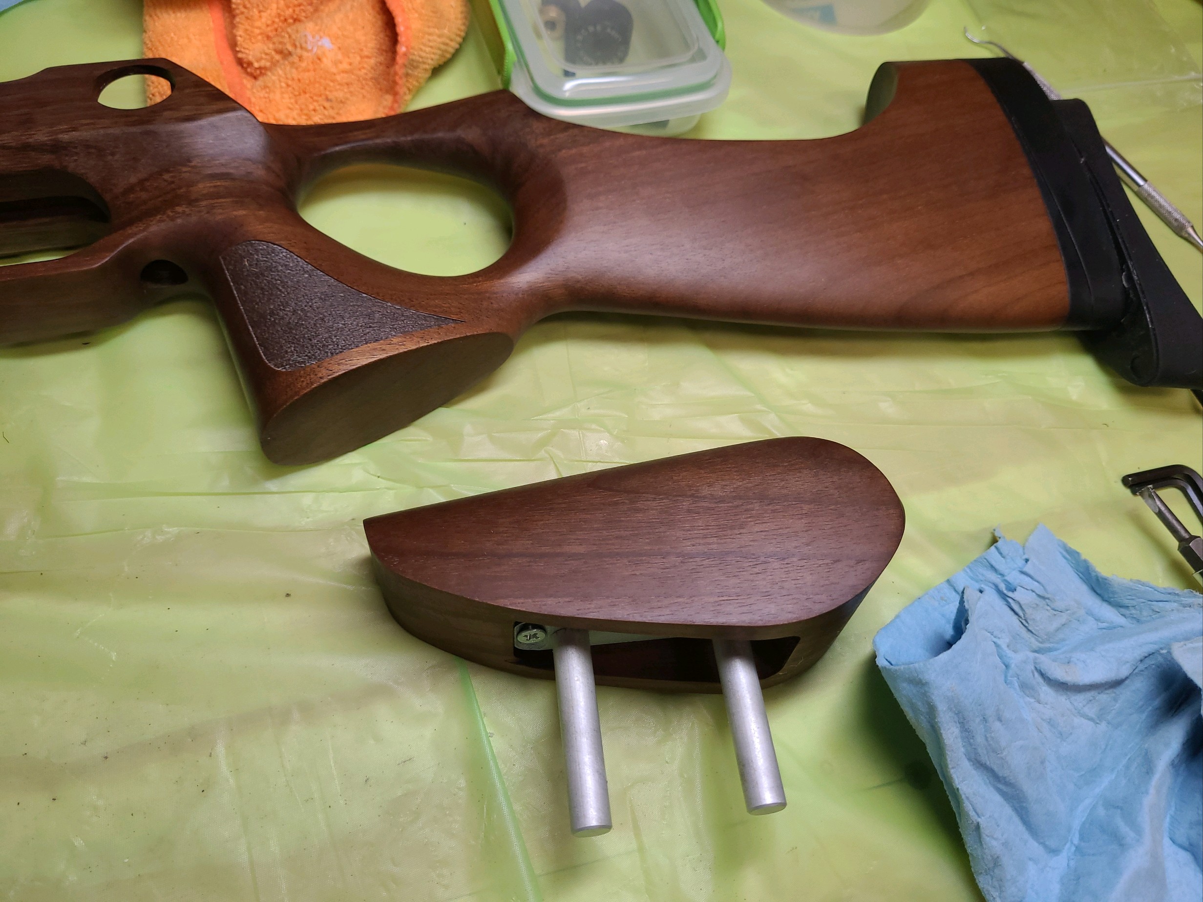

I've done mine. Not sure what coating is on but it's pretty thin. I would recommend sanding it off, then using a Walnut stain (the wood underneath was VERY light), then after drying, use whatever finish you desire. I used an oil finish for a semi-matte look, and it's also very easy to touch up if it ever gets scraped or dinged. I did several base coats of oil, sanding and polishing it in. With 8 final coats with increasingly finer abrasive.
Wanted to add that I also used a mild citrus stripper to get the finish out of the stipling
