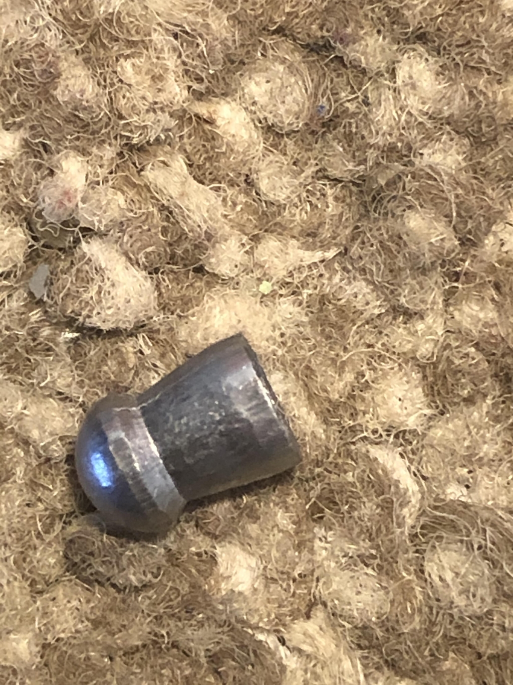

Fx crown spiraling
Hitting left like it is at longer distances may be because of how the scope is mounted. I have a new Athlon that I just sighted in with the Impact this a.m. and at 235 with a 21 MOA holdover it was shooting dead-nuts (but not quite an MOA group at that distance). Now, when I clicked the turret back down to the 100 yard zero it shot 1 MOA to the left. In other words, it isn't tracking perfectly vertical based on my mounting job.
You say it’s consistently going left. Do you mean at one specific distance? Spiraling can sometimes be eerily consistent enough to produce a somewhat consistent POI at one distance but usually there will be some apparent left/right randomness. What does it do at different distances?
Of course if you can actually observe it corkscrewing in flight, then forget those first questions.
However if it’s always landing to the left, you’re probably fighting a canting problem. Either the scope is indexed incorrectly to the bore or you’re holding the rifle at a slight angle when you’re shooting.
He is probably right "spiraling" and "arching" is not the same. If the pellet was spiraling, it would hit all around the target, left, right, all depending on what distance you shoot. One thing you can try is to index the liner, so the pellet hit the target at the highest point relative to your aim point. Then re zero the gun. I tried it on my wildcat, and it actually makes a noticeable difference, even on 10 yards.
