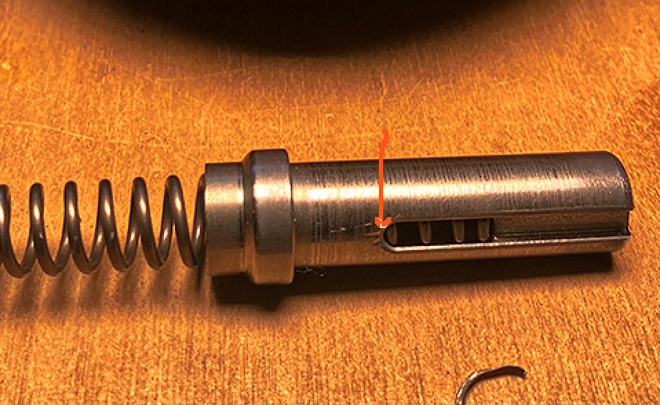

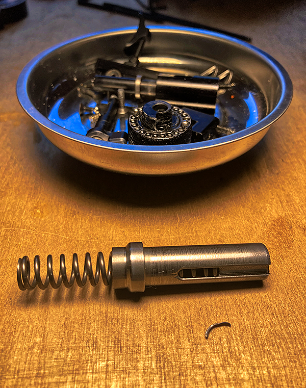

Well after practically disassembly the action and while moving the cocking mechanism I noticed that the hammer spring would not come out and figured this was the issue because it should of just fell out with just gravity.
After some prying of the hammer spring and moving the cocking arm it finally let go and the cocking arm went all the way back

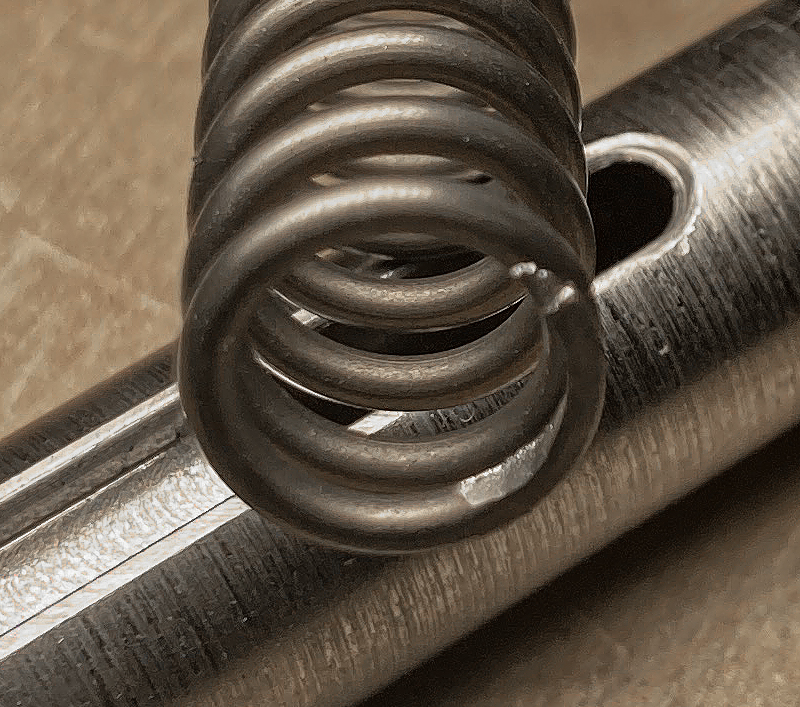

The culprit turn out to be a metal fragment off the hammer spring that wedged itself between the hammer spring and hammer interior.
Thanks all for the help and suggestions and Doug off line walking me through!
Now I'm not looking forward to the reassembly :confused:

I notice the open window on the hammer housing had some burrs on the front of the opening and went into the inside of it with a rat tail file and got rid of a growing hump and smoothed it out.

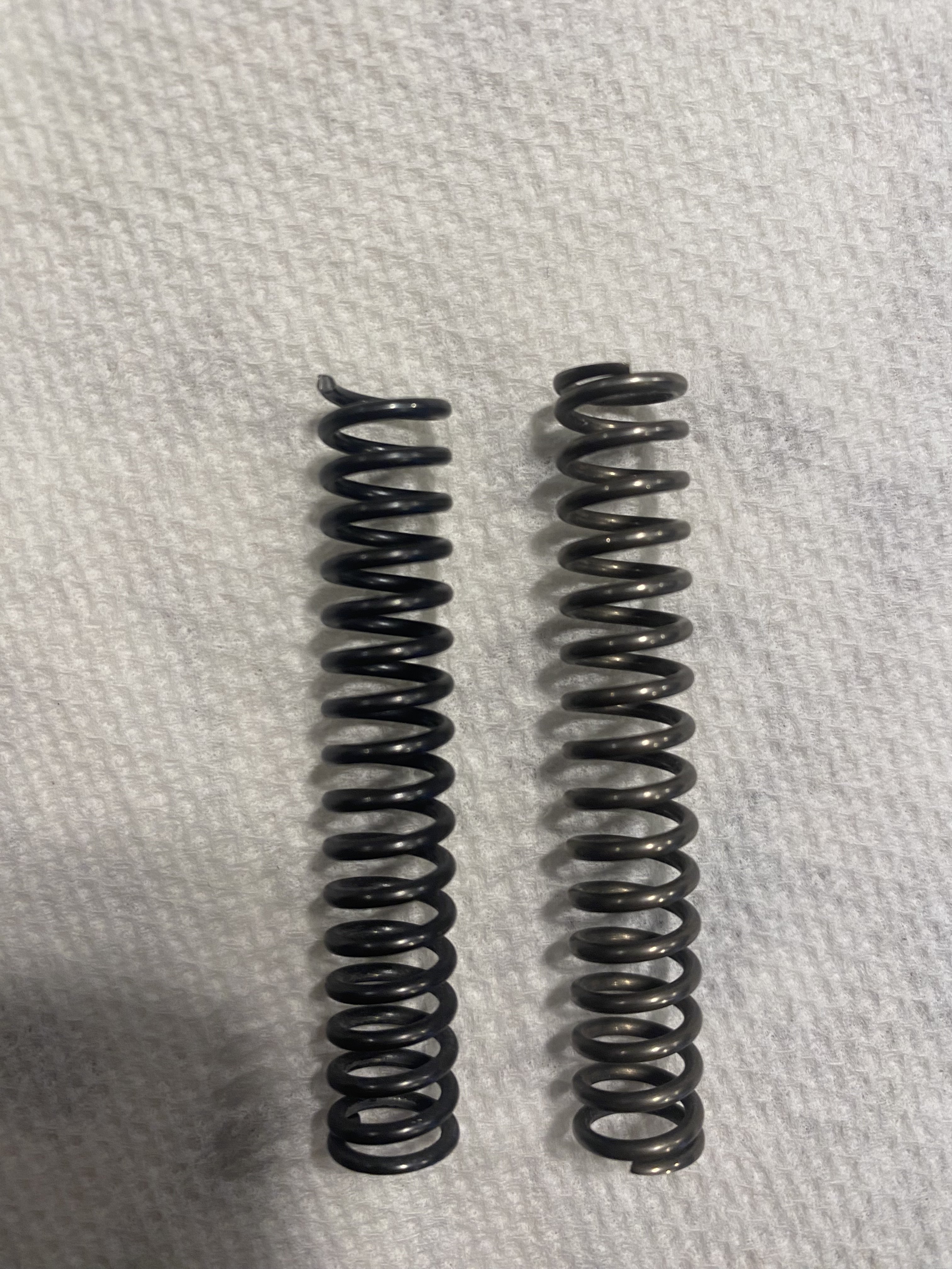

I wonder if setting everything to max may have contributed to it, 2nd reg at 155, stronger Huma Air hammer spring upgrade, hammer spring screw set to max. FPS at 955-65
Took some 3000 - 4000 rounds to happen though
I have recently Spoke with technicians at utah airguns and they told me that when you max out your settings On your hammer spring That it will inevitably cause the tungsten hammer to jam inside of the hammer housing. And sure as poop that's exactly what happened to me when I went and shot my crown the other day, But luckily my gun is still under warranty and the good old guys at Utah air guns sent me a replacement hammer housing and tungsten hammer for free. To all your shooters out there who have an FX Crown and have installed Your slug power kit be careful to not adjust your power settings to the Max. This will happen to your gun.
