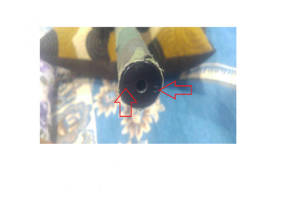

will poi and accuracy changes if we rotate Shroud?!
i talk about fx crown shroud.
There is a pin which indexes the crown shroud when extended. Rotating it off of that will shift your POI. Quite frankly, on my crowns, I simply moved the indexing point so that the shrouds can't extend at all and are locked fully rearward. I then mount a moderator to the muzzle, which is much more efficient at quieting the crown per unit length than the shroud. Hope that helps.
