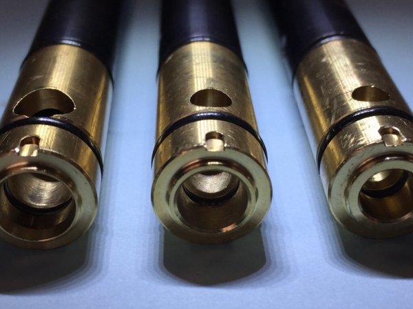

Each caliber barrel has a different size transfer port on the barrel. Here are 3 different caliber Impact Barrels .30, .25 and .22. The crown has an additional transfer port dial with 3 settings which restricts air flow between the regulator side and the transfer port on the barrel.
