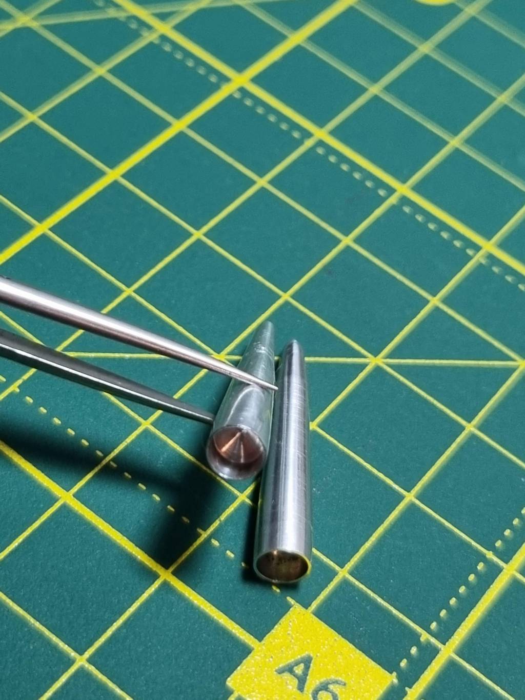

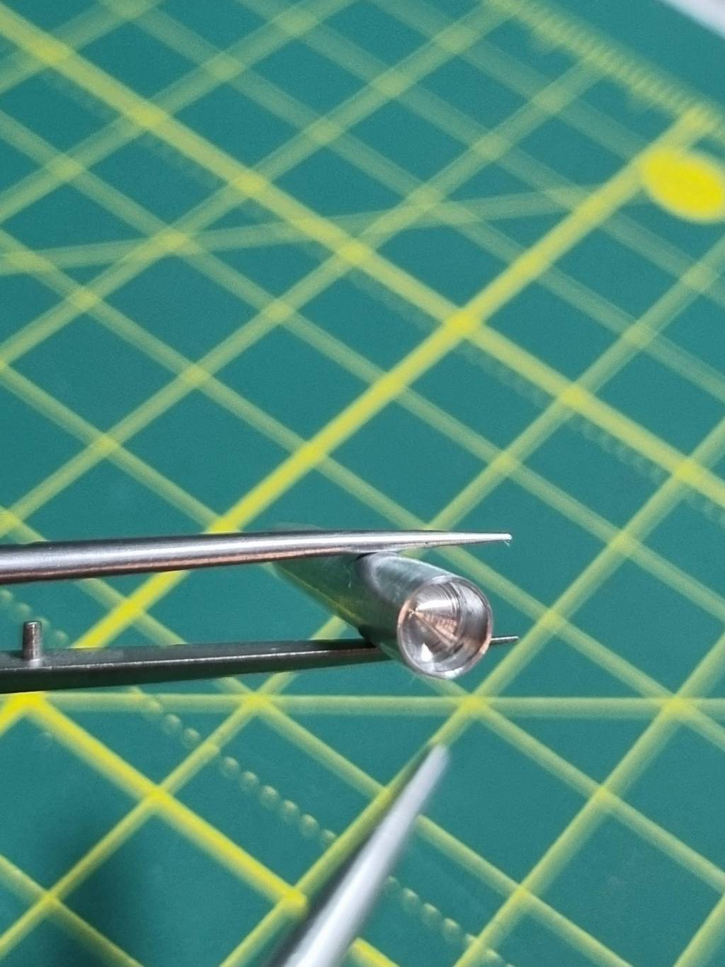

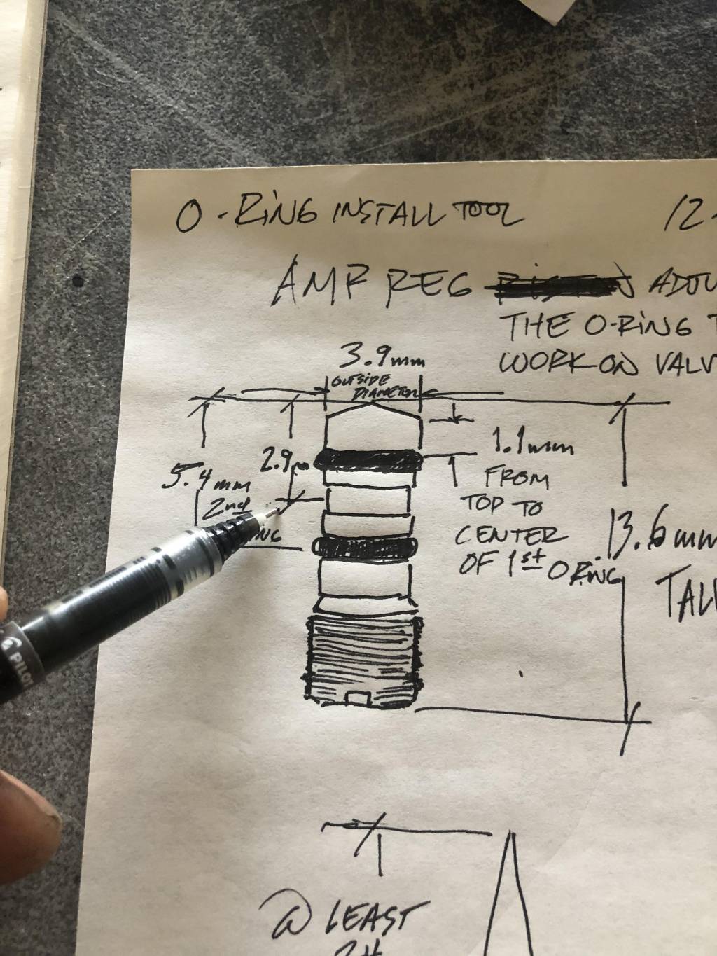

Jimmy!! I just had a member machine me aluminum “witch’s hats” just for this purpose. I pulled all the dimensions, designed a sketch so the second o ring goes on first then the first o ring(closest to the end) would go on second by just sliding it upward after it slides on to the adjustment screw. The guy did an awesome job.
Heck yeah Augie, that's exactly what I was thinking about almost. I hadn't really thought about sliding it over but that was an excellent idea. How about a photo of that 2X1 Oring laying next to the tool and one rolled up on it. That would put it more in prospective to show just how damn small they are. How long did yours end up being?
Thanks for sharing,much appreciated.
jimmy
I made it 24.25mm in length.
