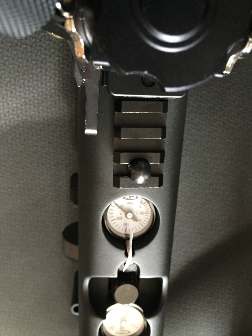

Just put a little flag on the set screw and took a mag full of shots and that "isn't it" it didn't move but the pressure setting did, it went down to 145 bar again same exact thing that happened last time.
Very confusing the screw didn't move after a mag full of pellets but the pressure setting did, from 150 bar back down to 145 and used 250 bar to 220 bar from the tank. Tank pressure is normal. How can the reg be lowering the pressure it's self? I hate puzzles like this! Got to watch what i write and be more precise with my wording.
Have you measured the muzzle velocity by chance? I would advise you to monitor this when you see a pressure change, could be that's it's just the pressure gauge itself that inaccurate some times. If the muzzle velocity is the same I wouldn't worry about it, if not than please report here and we'll find a way to fix it
Jimmy King replaced the gauges on his Crown with Wika gauges awhile back by making the holes in the stock slightly larger...you may want to think about doing the same thing. But if you PM Jimmy and ask him if he is happy with his new gauges I am sure he will be happy to discuss it with you. I know the diameter of the Wika gauges is 28mm so you could measure the gauge holes in your stock to see how much you would have to open them up. And if you decide to do so, here is a place in the U.S. that stocks the Wika gauges...
Yes I was shooting over the crono and the the velocities were all over the place. Standard deviation of 9 was the best, worst was 18. I think it's week spring washers they compress and don't return, that's my thought on what's happening.
