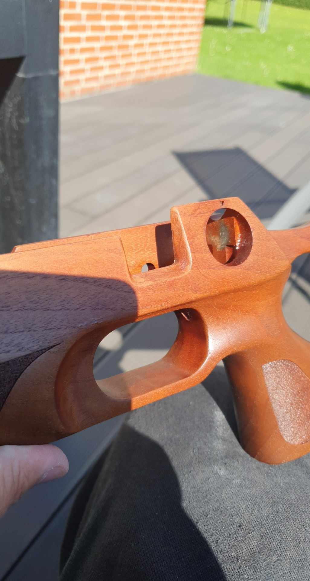

The best improvement I have done to my Crown mk1 since I received it was done this summer. - I really should have cut that sloth already after the first week. - I recommend It - Took a couple of hours - including sanding and oiling the whole stock... It is now so easy now to change from low fpe garden shooter to Slug shooter. I Also 3dPrinted some guides I can use to test the adjustments with. One end for Garden settings and other end for Slugs. Turn the small insex pinbolt and test the settings with the guide - I can change from low fpe to high fpe within 5 minutes now. I got a guide for .177 and another for .22 so easy. I hesitated doing this mod for too long time - I got my FX Crown in july 2019 and it took me 4 years to do this mod. What a waste of time - I took it out of the stock sooooooooo many times to adjust on the small Pin-bolt. You will never regret doing this mod. (Of course more challenging on a laminate stock - If I had a Laminate stock I would do it anyway now where I am familiar with the advantages)
Enjoy
