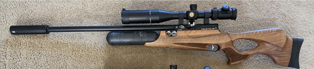

I have a Wolverine "R" and found it to be top shelf. I need a trigger that comes in ounces and the Daystate trigger did not meet those needs out of the box. Therefore, if you want a super light trigger, like I do, you will have to do some polishing and maybe change a spring to get it that way, but if you are ok with a very good, crisp, and fully adjustable trigger that does not break in ounces and do not have the need to adjust the power after every shot, than consider the Daystate.

I have both and would sell the Crown long before even considering selling the Wolverine. The Crown is highly adjustable, smooth, accurate, and ergonomic but is delicate and not really engineered to last. The W R is much more robust, less complex, and is a set it and forget it kind of rifle, which is what I've evolved into enjoying. I've only polished and adjusted the trigger on the W R and it's quite good at 9 oz, whereas the Crown has seen a LOT of tinkering to get it tuned right and reasonably dependable for poi.

I had to face the exact same choice a year or so ago. I tried both guns and went for the Wolverine R for the following reasons. The first is I am a big lad at 6ft 4 and the Crown just didn't fit me very well. Secondly I tend to set my rifle up and leave it so all the adjustability would be lost on me and finally, I thought the Wolverine looked so much better in walnut. Wolverine shoots very accurately and I have no regrets, however I am sure the Crown is just as good. At the end of the day it is horses for courses, go handle both before you pull the trigger.
