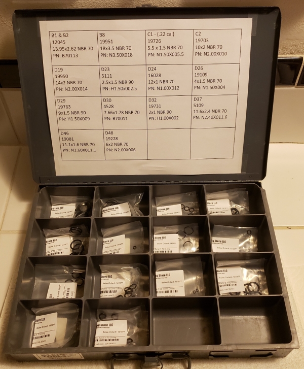

I recently bought a new FX Crown .22 cal, with a synthetic stock. I wanted spare o-rings to have on hand in case I needed them.
In the past, I bought spares for my Marauder from The O-ring Store and I got a lot of them for cheap, so I thought I would do the same thing for this Crown.
Using the exploded view/parts guide I downloaded from FX, I put together an Excel spreadsheet with diagram locations, sizes, FX part numbers, The O-ring Store part numbers and hyperlinks to the o-ring pages.
The exploded view/part guide can be downloaded here: http://www.fxairguns.com/support/
I just placed an order using this information and bought 106 pieces for $14, that included tax and shipping.
FYI: In the diagram for C1, .177 and .25 cal aren't exact matches with what The O-ring Store has.
If you find any errors, please let me know.
Cheers, PB
