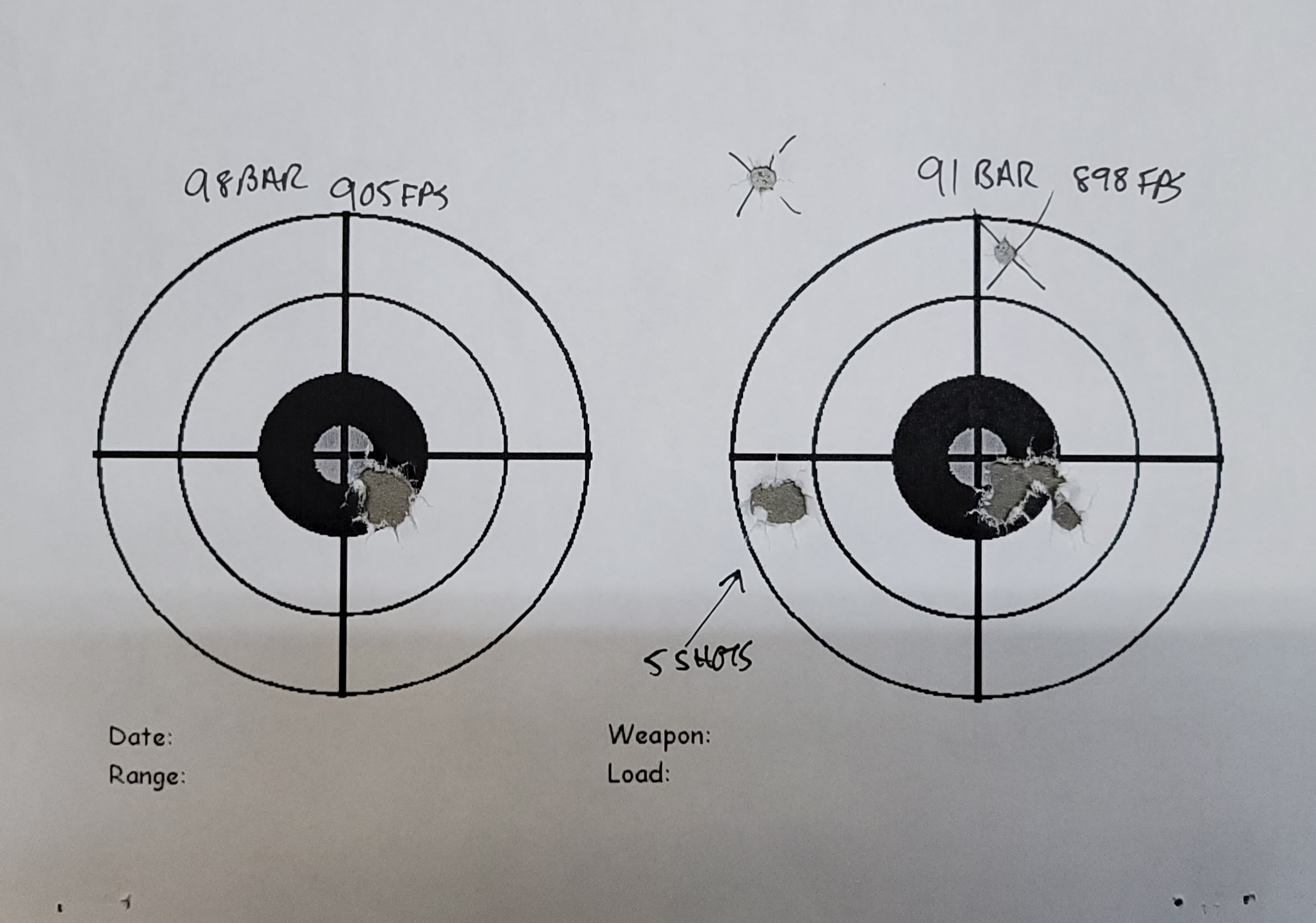

I'm guessing by the slight decease in velocity at 91 bar, it's a good tune for the current hammer spring setting. I think my reg gauge is off by 10 bar or so because on my last group it looked like it went off the reg at about 110 on my tank gauge.
Both groups (left and right targets) are 5 shots at 30 yards.
