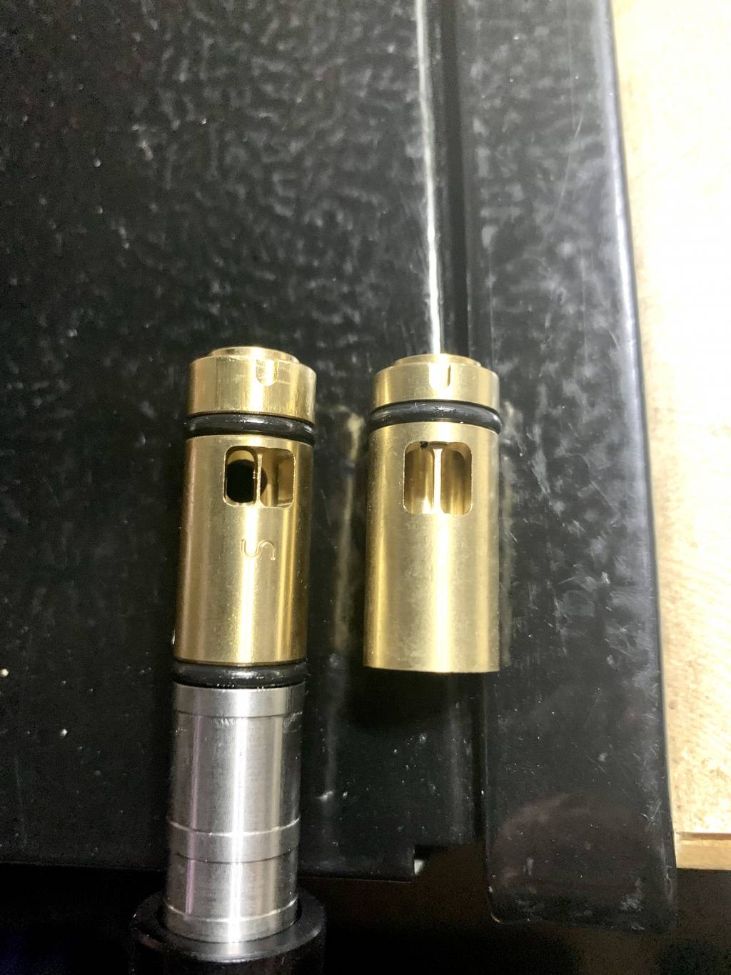

The new Crown comes with a “huma style” Transfer port already installed on it. I have the actual huma transfer port on several other barrels and even though the Crown has one that looks like the huma, the ports are actually a bit shorter. Here is a picture with the actual Huma dual hole on the right and the one that comes with the Crown on the left. Both are .25 cal ports
I will be swapping the Huma on to the 700mm Crown barrel and will be boring out the probe to match. In my experience performing these modifications yield better accuracy at high power. I feel like it smoothed out the airflow and that leads to a smoother shot cycle.
Thanks for sharing your gen1 numbers! Not much of a difference once you modified yours!

Humm, wonder if the difference in the orientation has an effect? Similare in theory, the shoulder angle on a center-fire. Orientation in Huma reg is straight forward while FX is rotated 45° instead of directing the gas forward rather than focusing the gas to the sides of the barrel.
I would think that it would be needed to raise the reg pressure to accommodate the new volume of gas avaible. Makes sense to me.
