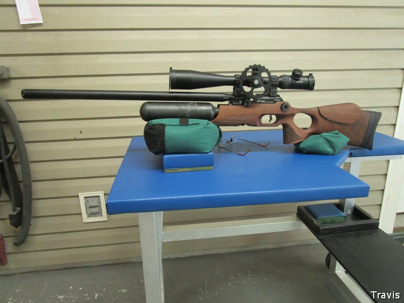

Hello everyone,
Got my new FX Crown MK II .177 cal in the other day and mounted the Hawke scope. Made enough shots to zero in the scope using JSB Exact Monster 13.43gr pellets. This morning I set up a new target out at 25-yards and shot 10-rounds each of 9 different pellets and very pleased with the results. The rifle shot 7 out of the 9 pellets pretty good but did not like #1 and #4. Shot 10 pellets almost in the same hole with #5 and #7. I have some Slugs on order and cannot wait to see how well they shoot.

Are my eyes playing tricks on me, or does your walnut stock have an adjusteable cheek riser?
Hello Long_Gun_Dallas,
Yes it does, I have not made any changes to it because if feels good, but I will adjust it later. With the position of my scope it is very comfortable to shoot.
