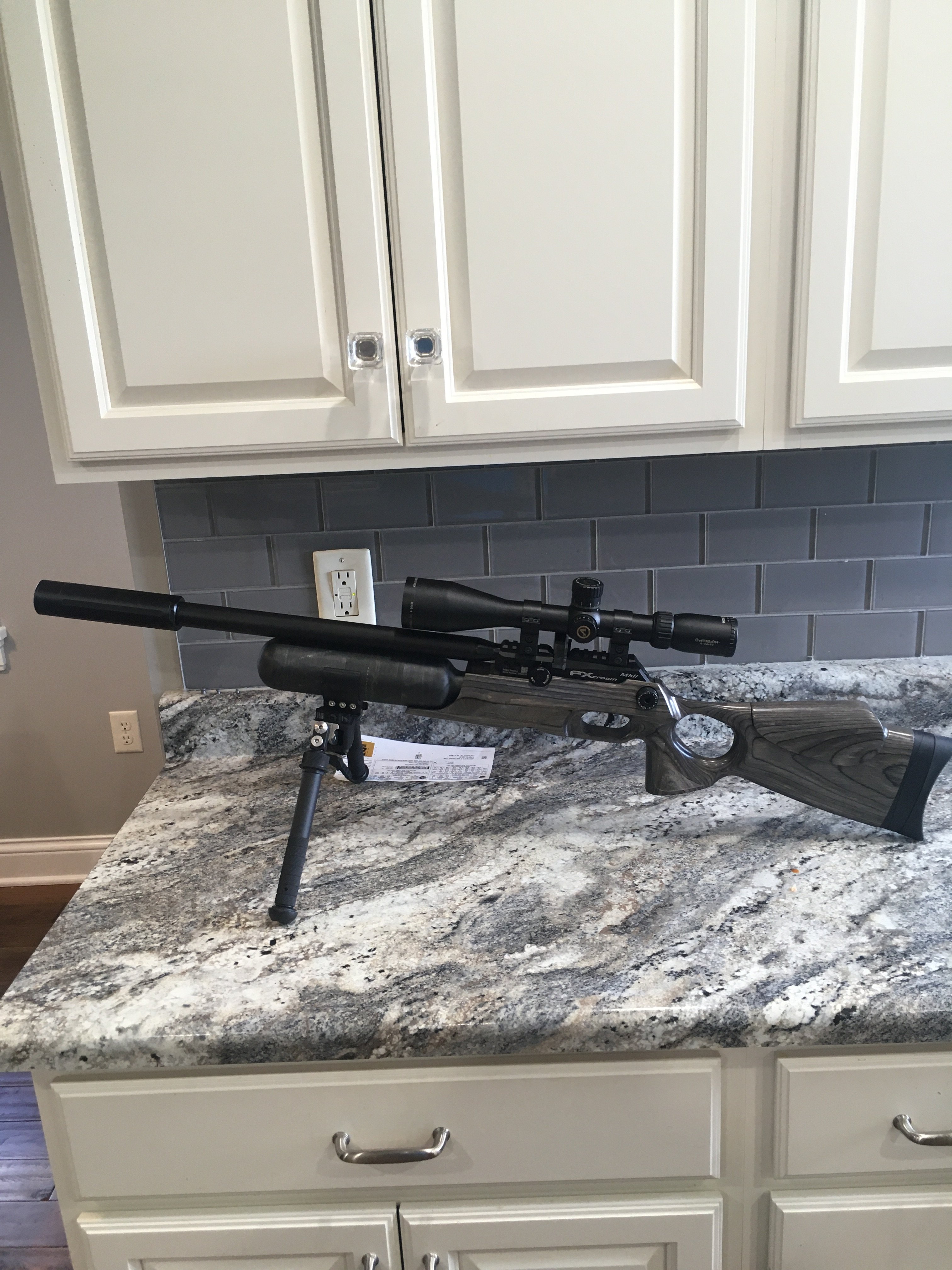

Does the FX Crown have a Dual Air tank adapter like the Impact has? Any insight or knowledge is greatly appreciated! Thank you!
I have never seen one and the stock would probably need altered to get one to fit. I get a bunch of shots from my crown mk2’s. If the 480cc bottles isnt big enough get one of the bigger bottles.

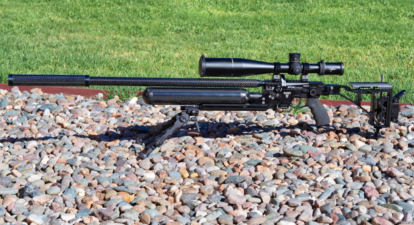

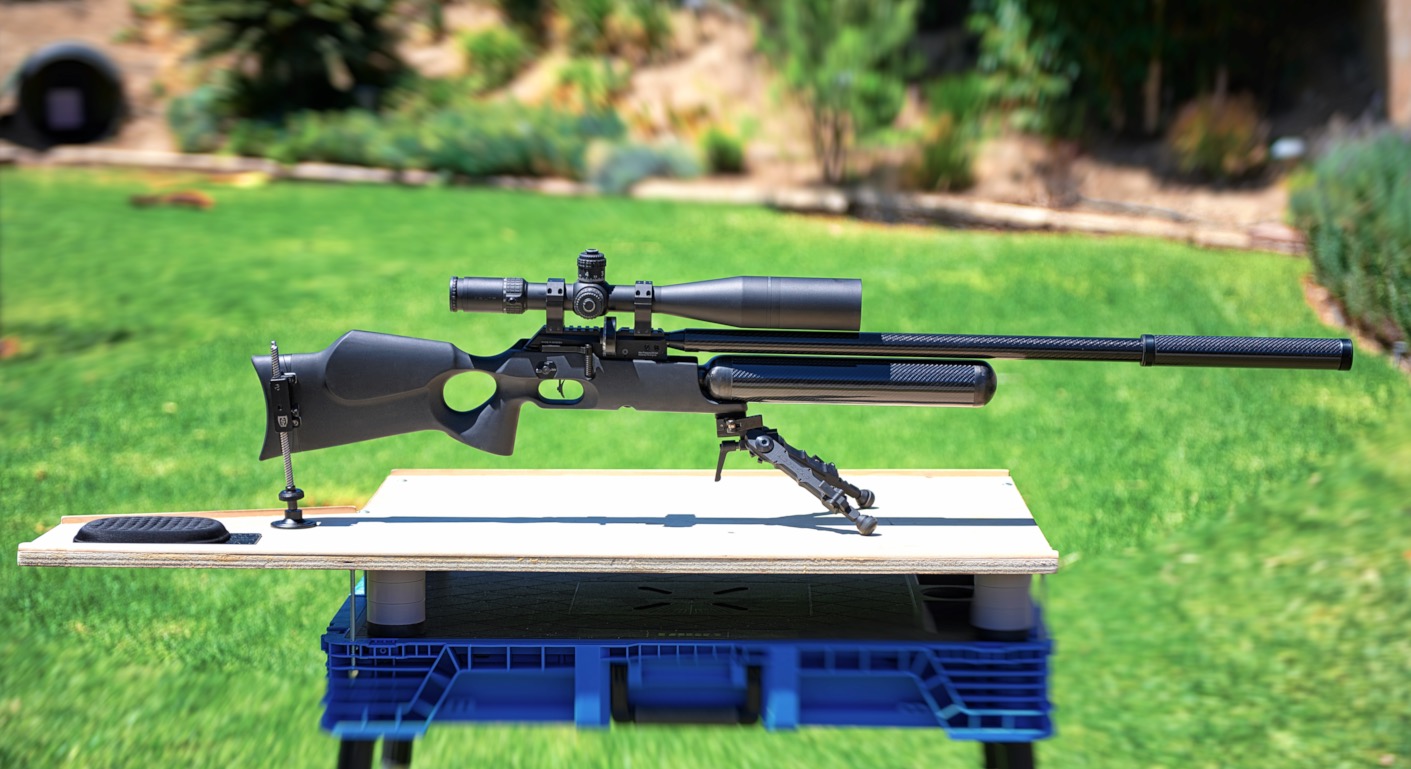

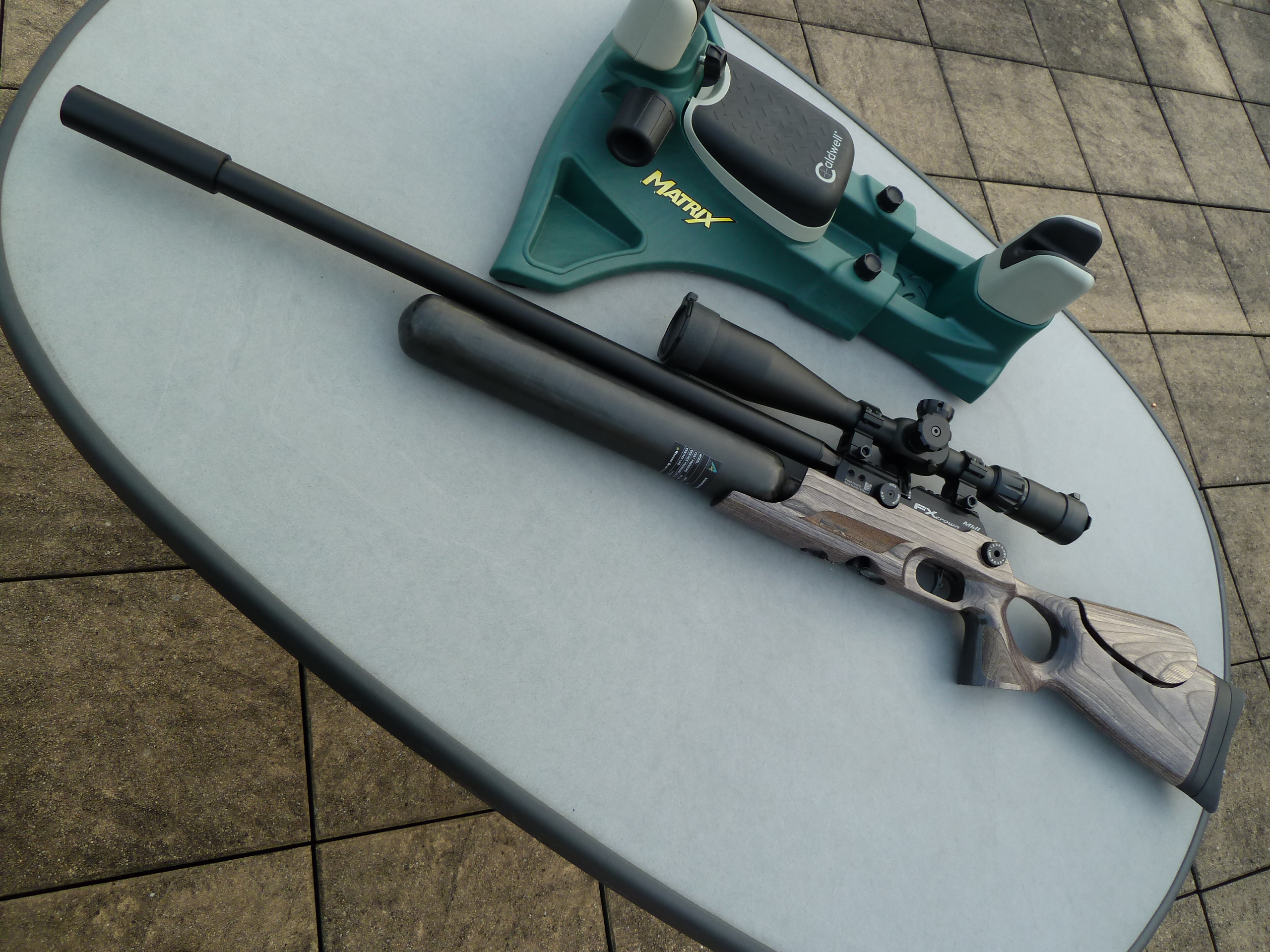

Why not consider the option of mounting a 700cc cilinder ? End result on a 600 mm barrel Crown visually more resembles a thick tube rather than a bottle. (to my eyes anyway - but feel free to convince yourself using the photo below). Moreover, when shooting 'free standing', balance now even feels a bit better than with the factory mounted 480cc tank (in my hands anyway).
From a 600mm barrel Crown MKII shooting the JSB 18 grains at around 920-925 fps, delivering a shotcount of over 300 shots per fill from 250 bar down to 100 bar regulator setting. (max velocity with 18 grains is around 970fps)
Am also shooting 21 grain H&N .217 slugs at around 930 fps (with the same 100 bar reg setting). Haven t counted shots per fill with the 21 grain slugs yet, but it still is a massive lot.

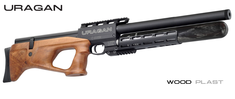

In the margin of it :
at reading your question my mind immediately went to visualizing an AGT Urugan with the relatively long cilinder top getting close to the barrel end.
I reckon if you like the combined look of that barrel and cilinder, then perhaps the combination of a long cilinder X short barrel on a Crown just might be to your liking too.
