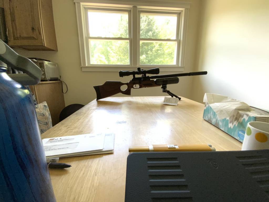

I couldn’t convince myself to drill my stock, but once the newness where’s off, I probably will. I went ahead and put a ST bottle clamp on it, and will have to cut the foam in the case to accommodate the clamp.

I have a real atlas on mine, but in retrospect would prefer an Accutac. The cant in very stiff on the atlas, and unless the bottle is tight, it will turn before the bipod will cant. A well mounted pic rail is preferable IMO.
Thanks Scotty,
I will probably put the atlas Pic rail on the stock, as it is going to be the most solid setup. I have an accu-tac pc-4 which just came today that will serve duty between the Crown and my other rifles.
