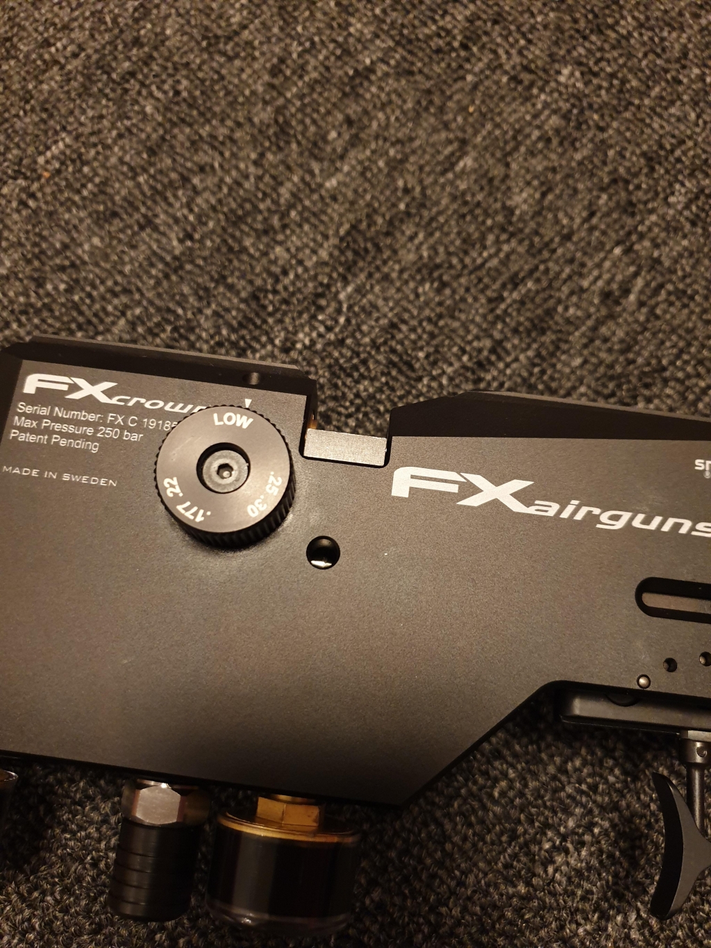

The only thing I can notice when shooting is that a puff of air comes out of the hole where you can see the valve pin. Is that normal or maybe the source of my problem?
I think this hole is normaly hidden in the stock of the Crown, so I have no reference.

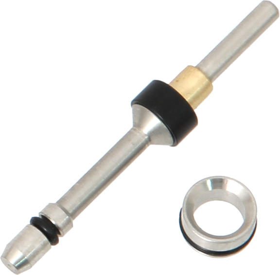

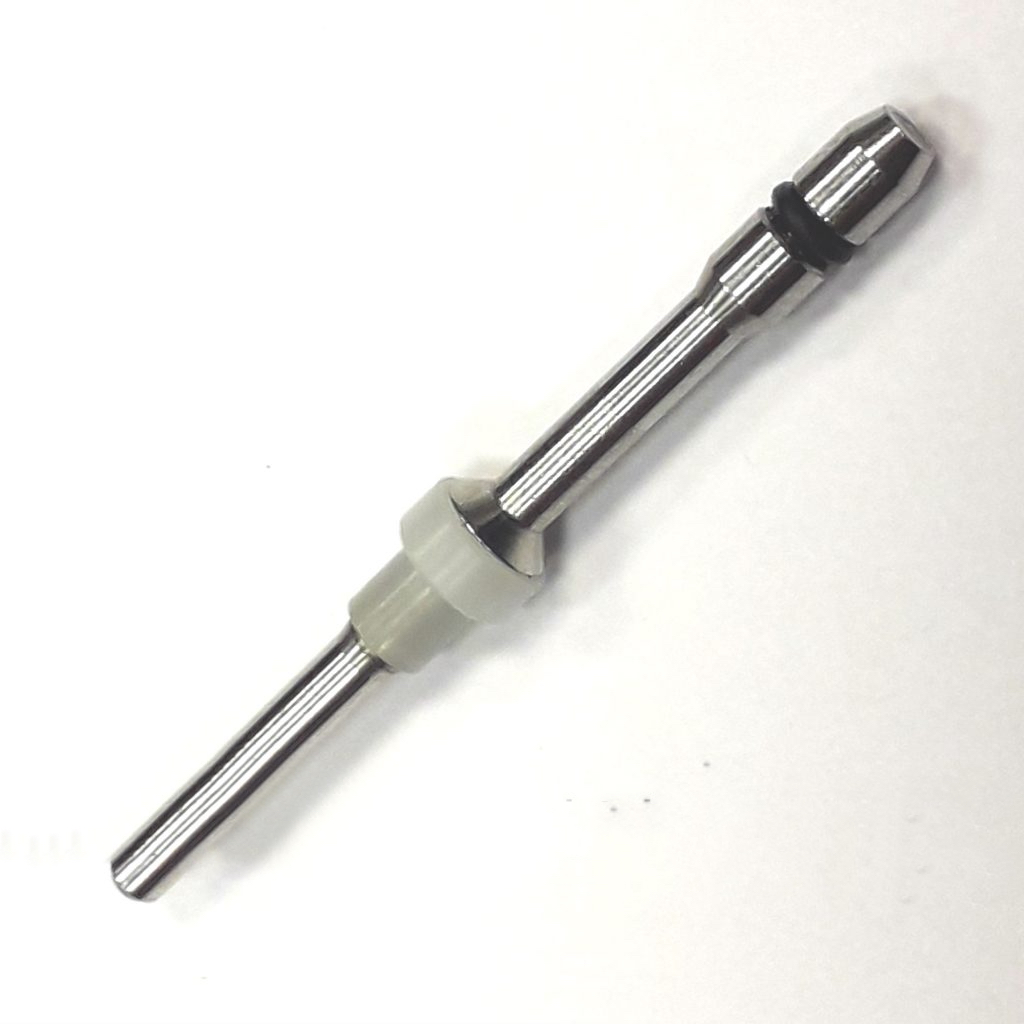

2. Normal when people install a enlarged valve seat on the FX Crown for a power upgrade, they also get or install a aftermarket valvepin which has a larger delrin plastic spring seat and possibly also made to fit the larger valve seat better. For a good sealing surface.
See pics:
Factory valve pin
Aftermarket or Custom made
Did you replace the tiny oring on the end of the valve pin? That’s probably where it’s leaking if the only time it leaks is when you shoot. If it holds pressure when not shooting it is not the valve seat or plastic valve disc.
