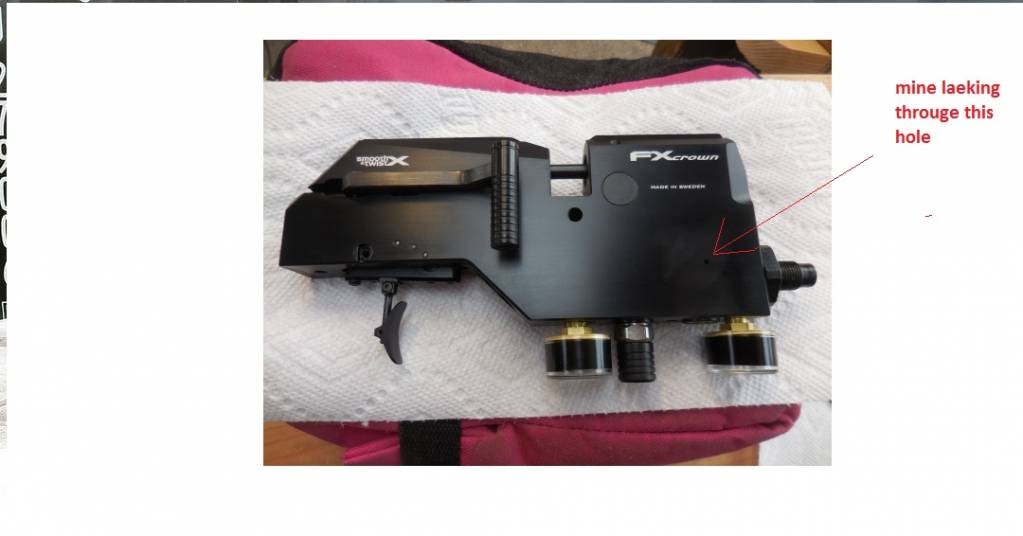

ok guys i got a leak not comeing out the barrle but on the side like right side there a small hole in the action and mine is leaking air out of it i see if i can post a pict
