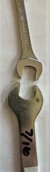

If I had to guess I would say your air bottle gauge is leaking. Evidently it is common on the Crown. I received a new Crown Continuum from Pyramid Air (after paying them the $10 for 10 check list (one of which was check for leaks) and it leaked right out of the box. After zero help from PA (except the recommendation I call FX in North Carolina and talk to a tech) and lots of opinions on this forum, I was able to figure out it was the air gauge. FX sent me new and improved washers for the gauge and that fixed the problem. I had to buy a "thin" 11mm - 7/16 open end wrench that would fit between the gauge and the block. Here is the thread discussing my leak:
