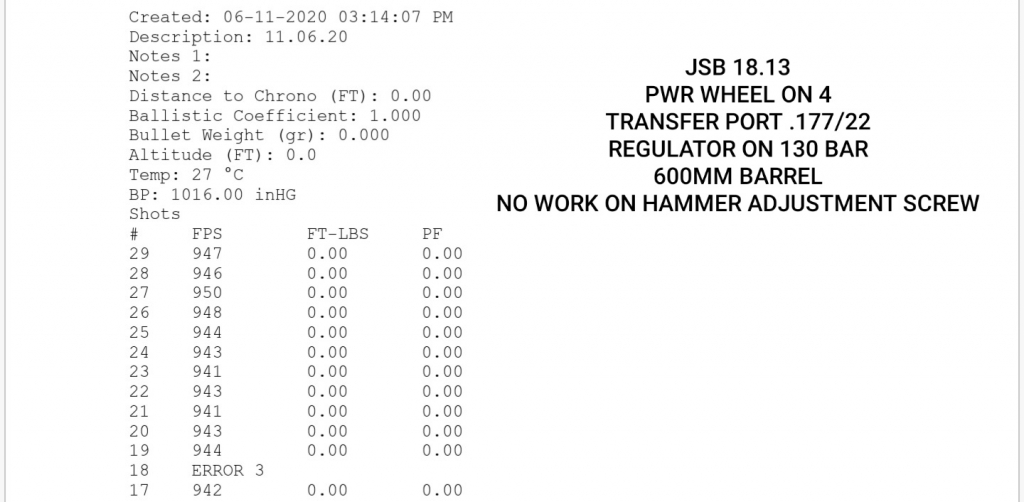

Firstly this rifle is working very well, only a few days old if I may add. I'd seen videos of regulators recovering quickly after shots but mine takes a bit of time, just wanted to know if it's because it's new and that it's ok or if that lag is an issue. Can't seem to attach the video but i came set at 130 bars if I take a shot it goes to 120 and slowly heads back up I'll say about 10 seconds and more. I can attach a photo of it's Chrono results.
Shot string looks good. Manometers aren't always 100% accurate FYI. Last Guy I told him to put a piece of painters tape right on it. Yo!

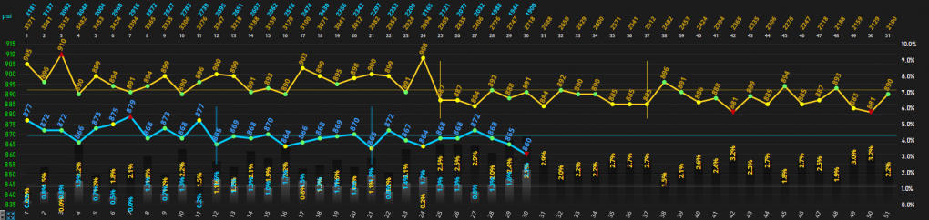

First, let me show you, a string with a regulator that has very small air flow, compared to one with large air flow such as mine...if you pay enough attention, and observe both have a slight decline over their string...why is that you ask, that both succumb to such effects? Physics baby, yeah. I wont bother debating you as I have supporting evidence to show your claim is actually...baseless.
Yellow string = small ninja style reg
Blue string = my lane regulator with more airflow

The shot strings looks normal!!!
