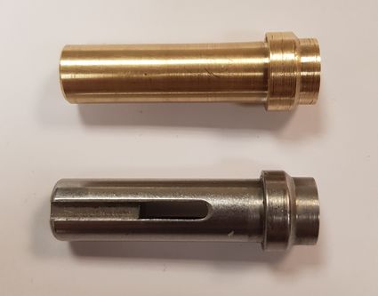

I'm looking for information on a heavier hammer for my Crown. 25 and of all the threads I've read, I was struck by this. My question .... Why not actually make a brass weight with the same size and shape as the original FX one? If you know a good turning workshop or are able to use the lathe, you spend less than the hammers bought on ebay and you are sure that the hammer is fine and the spring guide must not be shortened.

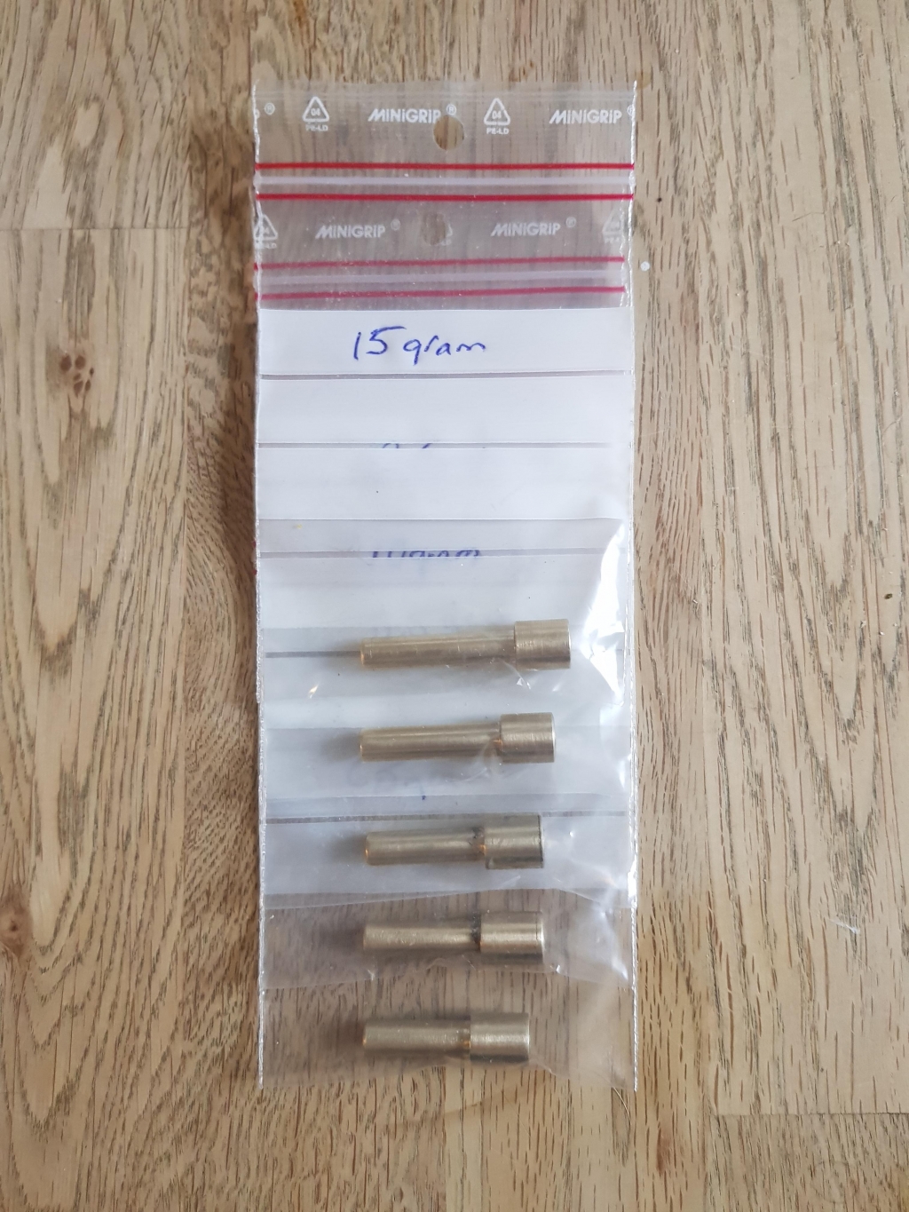

Well I'm sorry for the late respond but here is a simple test of all the weights. Interesting result.... In my crown all the weights give simulare result
Long_Gun_Dallas You reach 65fps its nearly 90Joul in 0.22 I have caliber 0.25 What in earth have You done to fix that... Se my result in the pdf

@shas, ​​thanks for the reply. So, from your tests, I read that the power is identical, regardless of the weight of the hammer used, obviously the power rises with the increase in pressure, but identically for all 4 weights. But at 180 bar, the Joules developed are very few ... I thought more. Reading in the forum, we read of people who at such high pressures, with the crown in cal. 25 get almost 100J ... I ask myself a question .... what other jobs may have done to get so much power.
What are you asking.. to make a brass version of the (thin) hammer? I produced almost 80FPE with my Continuum in 22 cal, if you want that level of power you should modify your spring guide, crank up the pressure, and use a proper hammer weight. I'm not sure why you are opposed to modifying the guide 🤷‍♂️

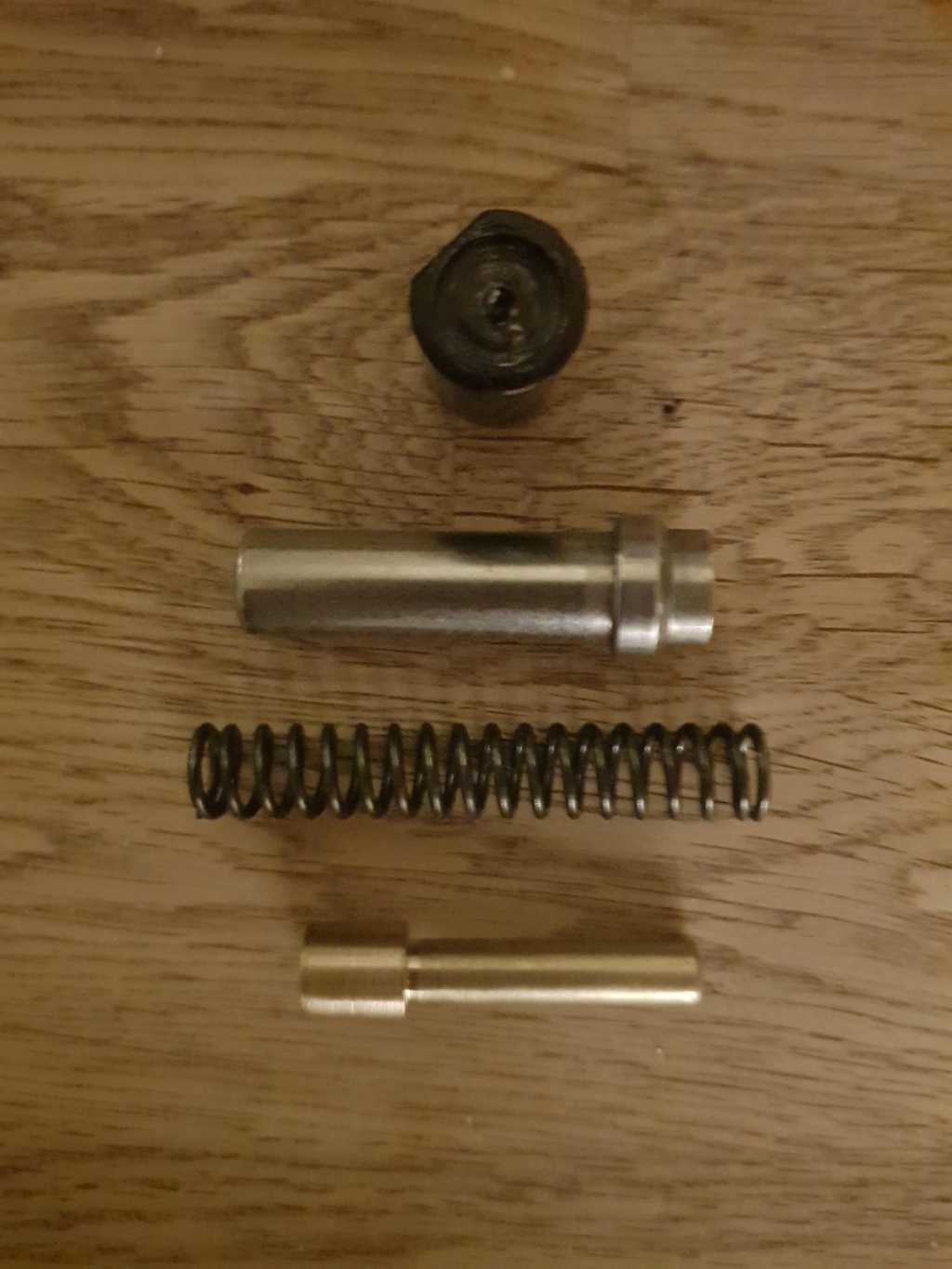

Hi again !
I have of course open up my valveseat to 6.35mm and uses a the new model of valvepin. I have also fixed the barret inlet 2x6mm holes so it should be a bit better power from this gun. I must have missed something...
I'm looking for information on a heavier hammer for my Crown. 25 and of all the threads I've read, I was struck by this. My question …. Why not actually make a brass weight with the same size and shape as the original FX one? If you know a good turning workshop or are able to use the lathe, you spend less than the hammers bought on ebay and you are sure that the hammer is fine and the spring guide must not be shortened.
Well the answer to that question is that the original hammer is from the beginning made of a very heavy metal. This solution is the cheapest and very easy to modify with different additional brassweights.
