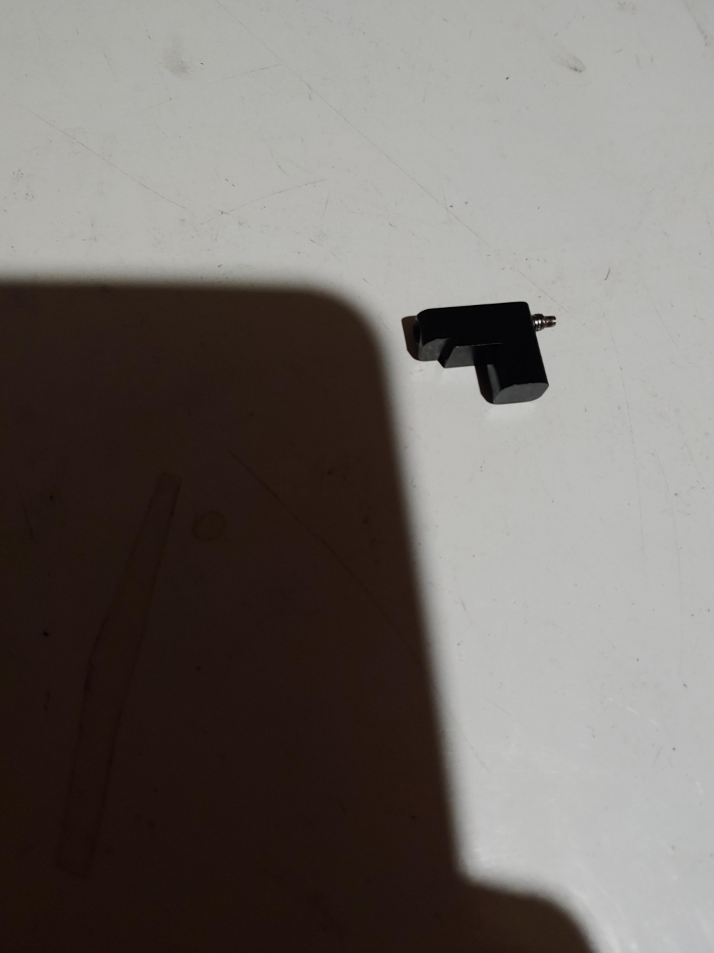

I got another Crown yesterday, this time a Continuum (.22). Bought brand new and was running some shots over the chrony and when I tried to adjust the hammer spring the thing would not budge....
I took the adjuster out if the action and was able to get it to turn maybe a turn and a half either direction and it just locked up.....To the point it bent my Allen wrench!

I am guessing was just never adjusted as it does work as is just not able to increase the hammer spring tension or decrease it....

Yeah, When I tried adjusting it and realized it was not budging with the usual force it takes with my Other Crowns, I popped it out...
It almost looks like the screw itself was not centered in the block and bound up....
Tried breaking it free and backing it out etc. but would not budge even with a bit if heat...
A bit hard to tell in the pic but you can see how the end of the screw that is outside the adjuster is off by a few degrees....
New one should be here Wednesday or so and can get it wrapped back up...
