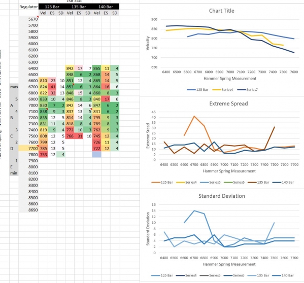

I've done some extensive testing with the Crown to attempt to resolve the issue of high ES and SD with my crown. LDP on another thread labeled "Tuning Discussion" gave some really good insight into the process.
I've taken that information and performed a little experiment that I'll share with you guys.
Important Notes:
1. Using a Digital Reg Gauge connected in place of my regulator gauge to ensure my regulator was set at each setting. (Reg Pressure was taken at 230 Bar Tank fill)
2. The hammer spring measurement denoted in the tables represents the caliper reading in inches from the leading edge of the hammer spring block to the end of the clearance slot for the allen wrench.
3. I shot a "poop LOAD" of pellets doing this testing!!!!
Here are my results (Each value represents a 5-shot "shot string":
Observations:
1. The valve system of the crown seems to be more stable at 140 Bar as noted by the lower ES/SD numbers posted. this for me resulted in less of a vertical spread at 75+ yards.
2. Once the hammer spring gets high on the plateau (read "LDP's post on "Tuning Discussion"), the valve becomes unstable and the ES/SD moves all over the place as noted in the graphs.
For "My Gun", the best setting was right on the knee with reg set at 140 Bar, Velocity moves between 845-855, My hammer spring measurement on Max is set at 0.6700.
I'm currently testing at different velocities and so far, 845-855 is best from my first day of testing this weekend.
Now, with all of this testing, I'm still not beating my Boss or Impact "in the wind" but the crown barrel has huge potential with the way it shoots the 25.4s with no wind.
I think we are all trying to get the heavies shooting in the crown as good as it does with the 25.4s. I'm beginning to believe that the barrel sleeve that has shipped with our guns may need a different twist rate in order to maximize the potential of the gun and reach the same level of accuracy "at distance" as the 25.4's.
I may make a video to help illustrate the testing technique as there are many other observations that I found very interesting.

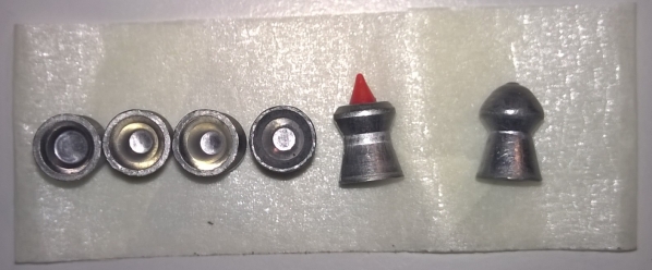

​I added a picture to show that the 2107 JSB is different. This pellet seems to shoot with a higher velocity as well with the same settings. 970 fps at MAX but than they shoot to hot and the group opens up at 50. The 2016 JSB seemed to like 925-930 FPS better than 900 fps. At 900 fps grouping at 50 was terrible. I added a picture to show the difference between the pellets.
​JSB 2017 skirt is not as deep. 2016 and 2015 look the same, 2011 (also shoot extremly well) has a thinner skirt. Polymag and H&N did not shoot bad at 50 meters. Not as good as the JSB 2017 though but for hunting more than sufficient. Is your BOSS a .30. I shoot a FX bocat .30 at the 100 meter benchrest competition in the Netherlands (indoor)
