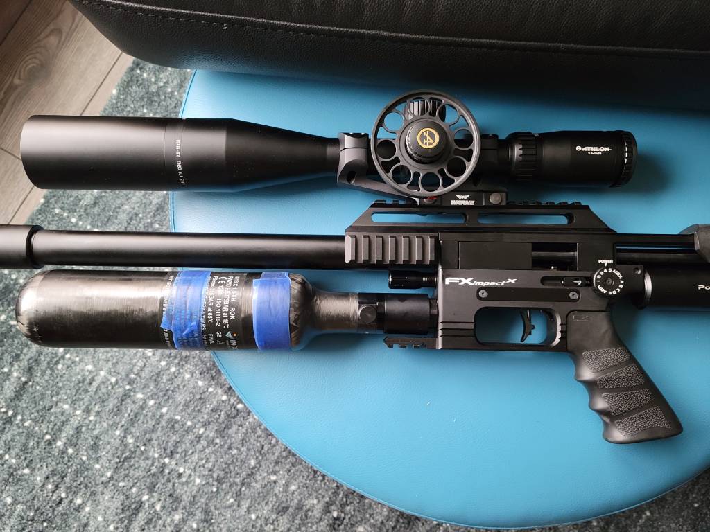

Re: FX .177...I am happy with my Impact in .177 setup for HFT at just under 20 fpe. Hoping it will someday shoot as well as my Air Arms HFT 500. To that end, so far I have added a Huma 2nd reg (improved consistency) and a carbon fiber barrel sleeve. Polishing the barrel helped quite a bit.
My setup is a 500mm barrel with a 100mm stripper so it looks like a 600. Prefers JSB 13.3, shoots the 10's well also, and Barracuda hunter extreme (no go with JSB Hades). Hoping to try a 600 barrel with the carbon fiber housing...probably overkill but I am enjoying the journey down the rabbit hole.

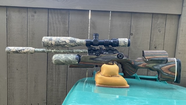

So for sh!ts and grin I got a 380mm 177 custom chopped barrel from a member here and added carbon bits I always do. It shoots the 10.3 grain pellet at 900fps into the same little hole over and over again. I do think it’s an older STX 177 barrel not the newer superior version because it is not as consistent with crosman pellets like my other newer FX 177 liners. Still does fantastic with JSB 10.3g pellets, will try beasts later. I do think the crown does have what it takes to be very good at HFT but need the right tune. Down side of having massive adjustability is we can mess up our guns really quick! Hahaha
