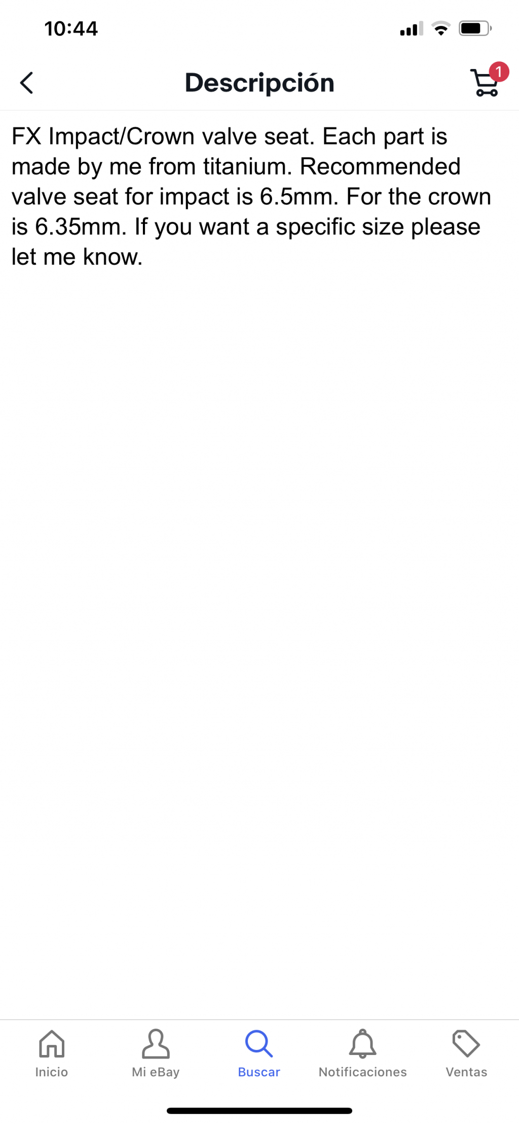

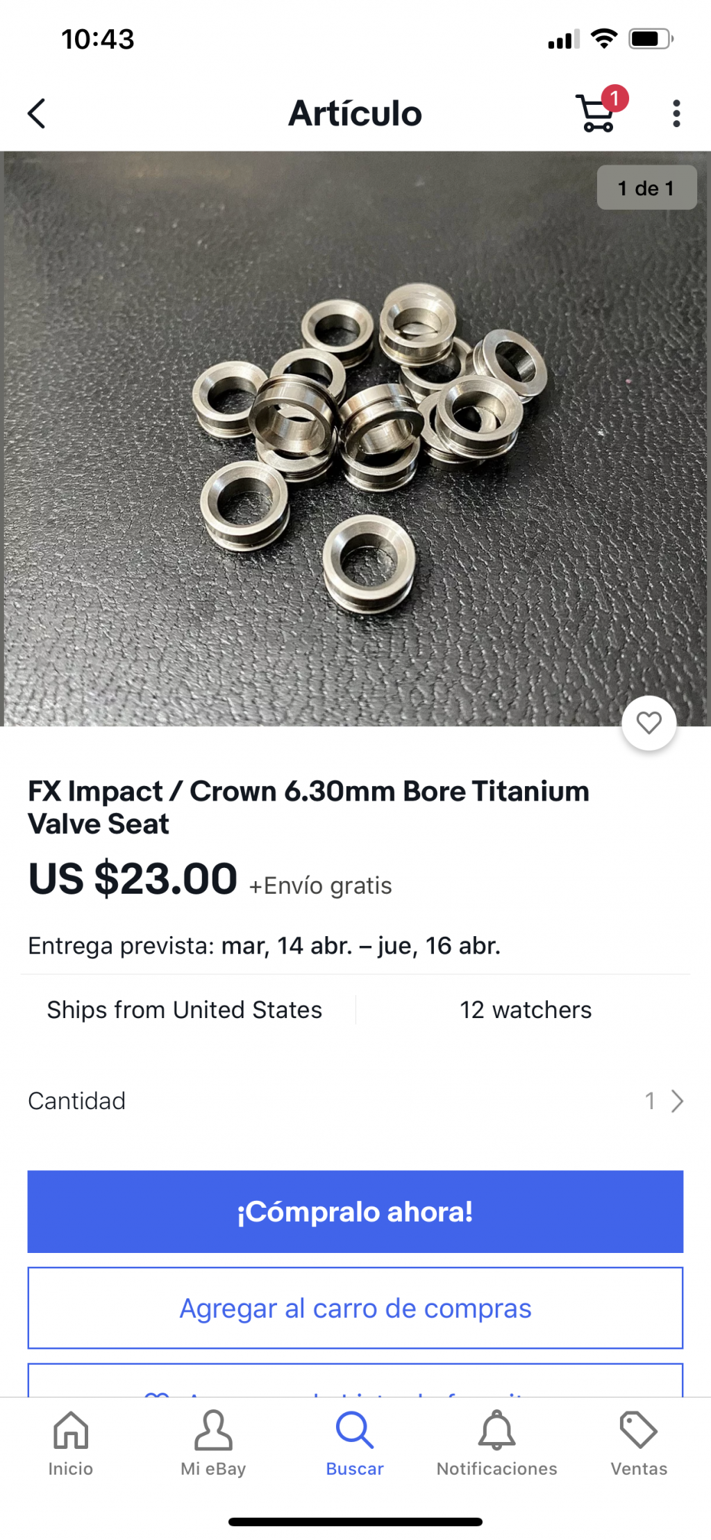

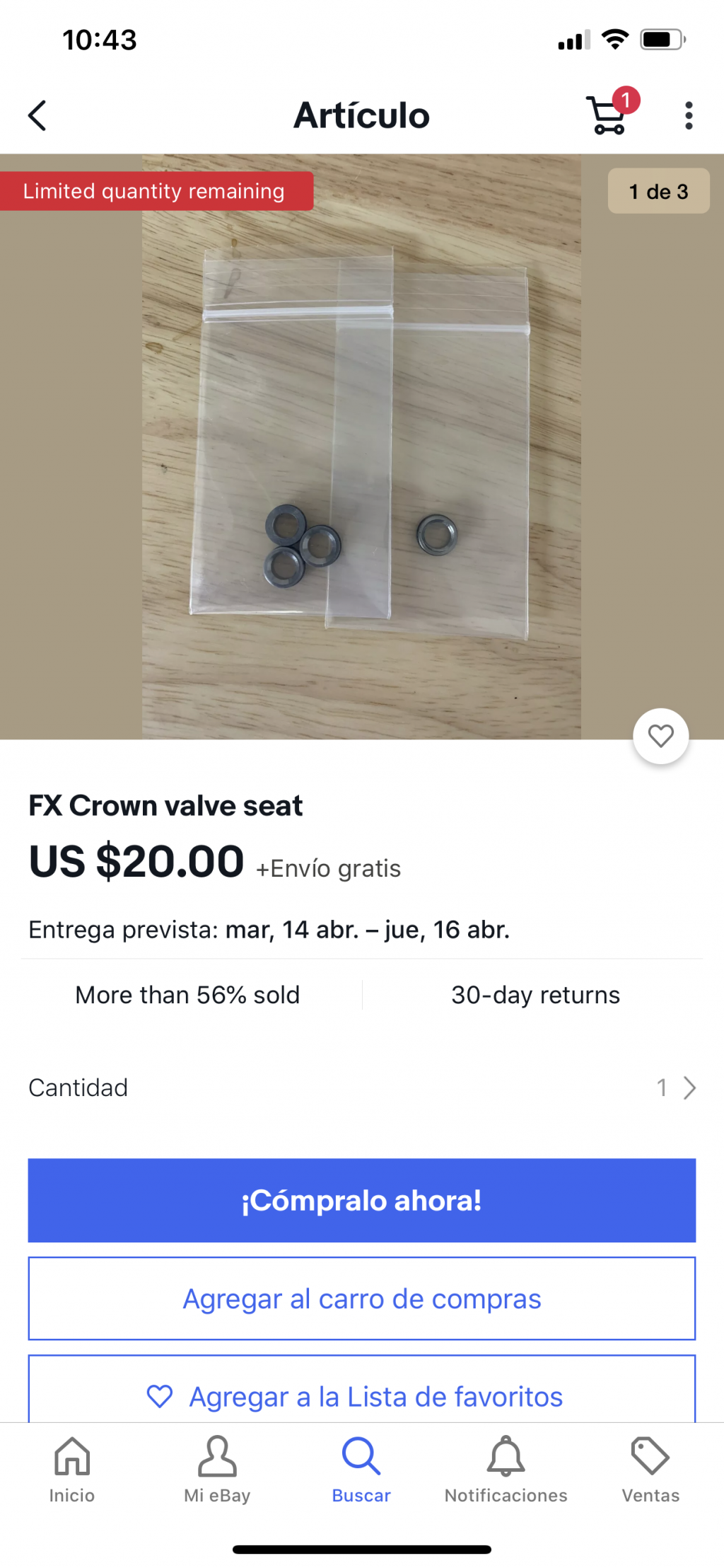

I found those valve seats on eBay which is better than which to shoot at 175 bars, and is the hammer weight well 7 grn for 175 or heavier?
Could you send me the link of the other thing that I have to buy?
