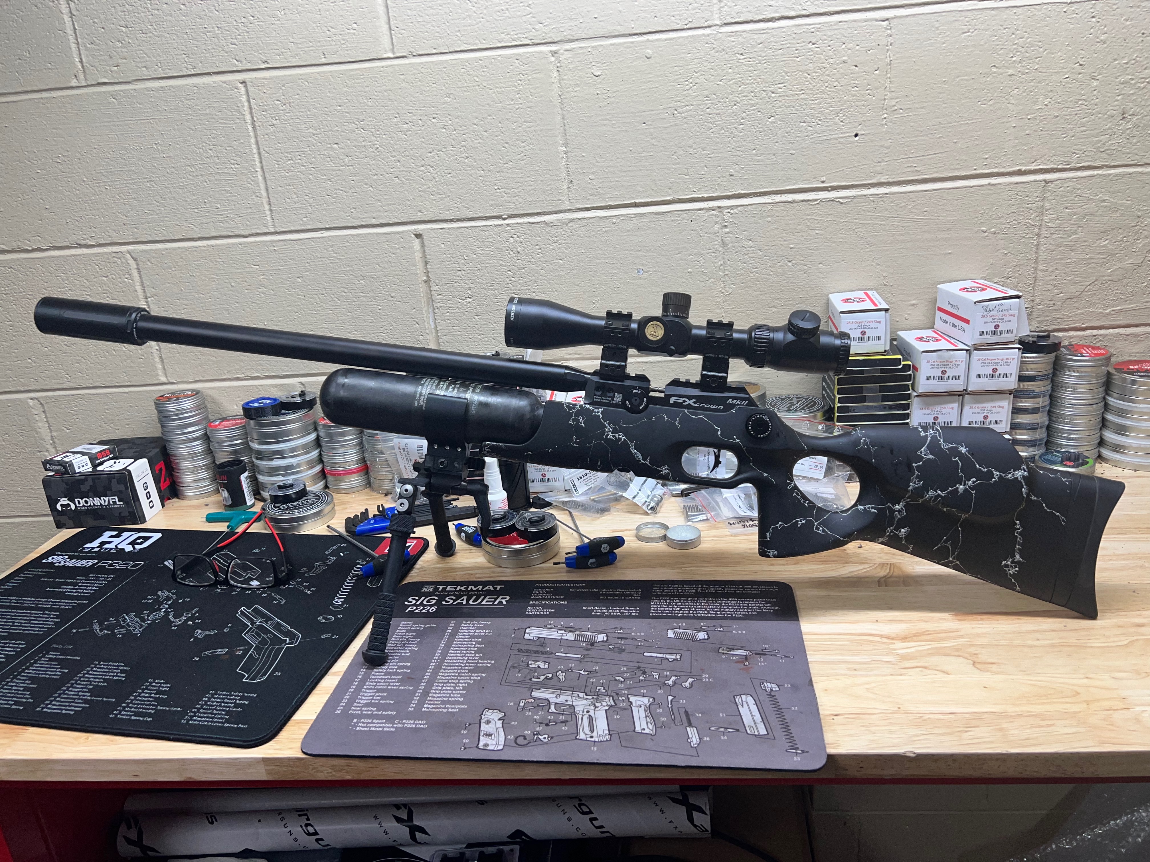

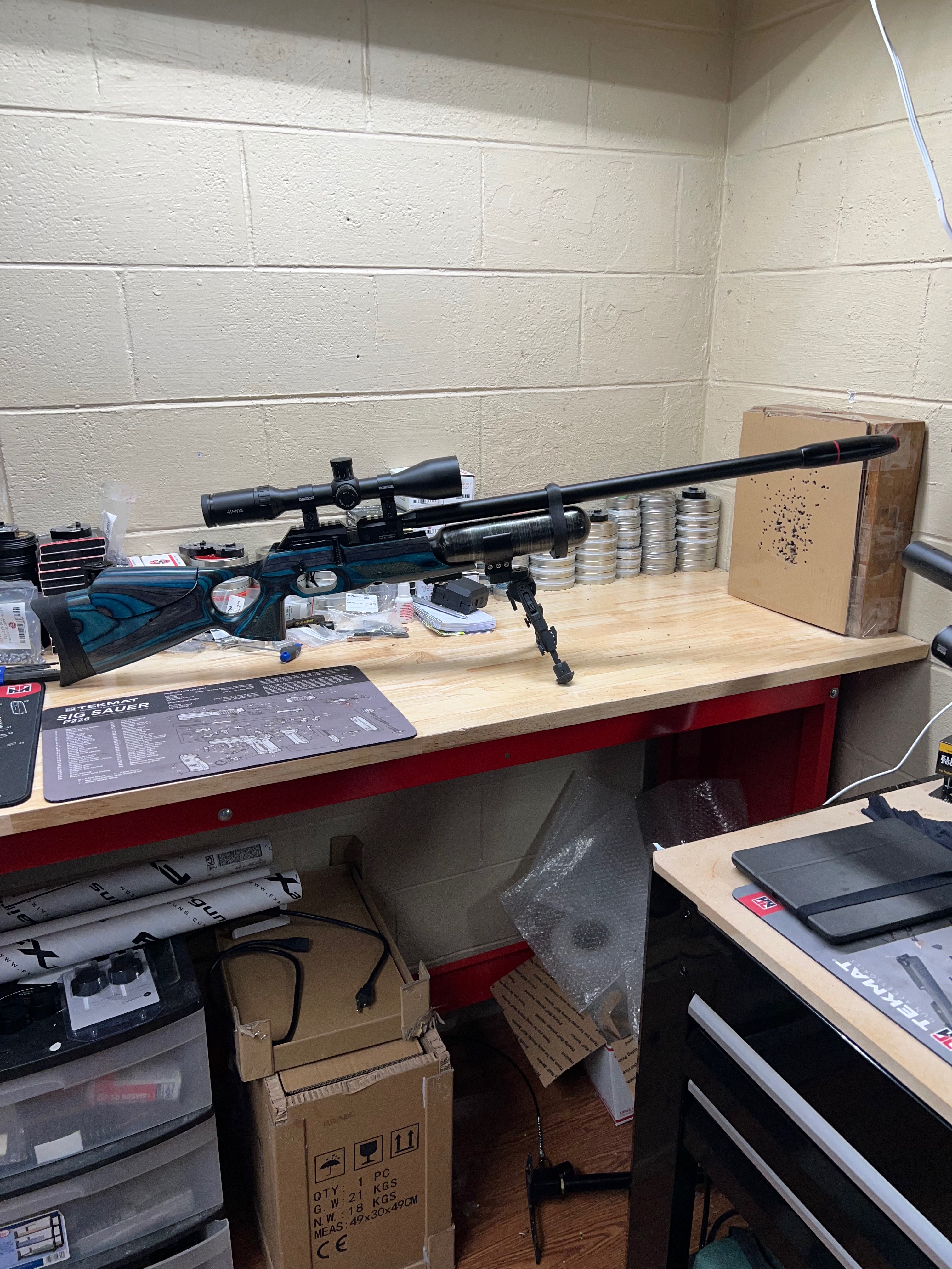

It's hard not to like the Crown. I have one more coming this week from Utah Air that has been hydro-dipped in Black lightening. I really looking forward to seeing how it turns out. The synthetic is really lightweight, plus I already had the one laminate stock I really like. The Blue Laminate is a 25cal and the Synthetic is .22cal with 500mm barrel.

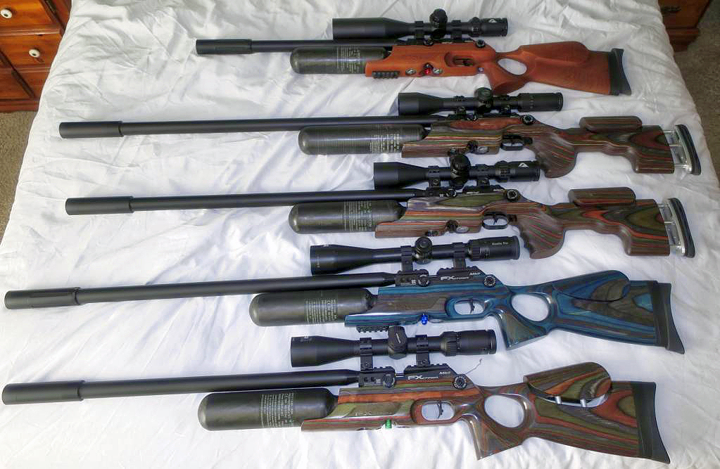

I have 2 Crown's in 600mm after having the 300, 500 and 700mm barrels the 600mm is the best to me with a 700cc bottel on both
One member here has 5 of them at one point, maybe more View attachment 319314
This makes me feel a little better about my “excess” with 2 Crowns. I do regret selling my crown Gen 1.5 or Gen 1 with pic rail on top. It is better at lower power range and the action is quieter with lighter hammer, it is an amazing pellet shooter, hope one day I’ll find one in classified for a good deal.

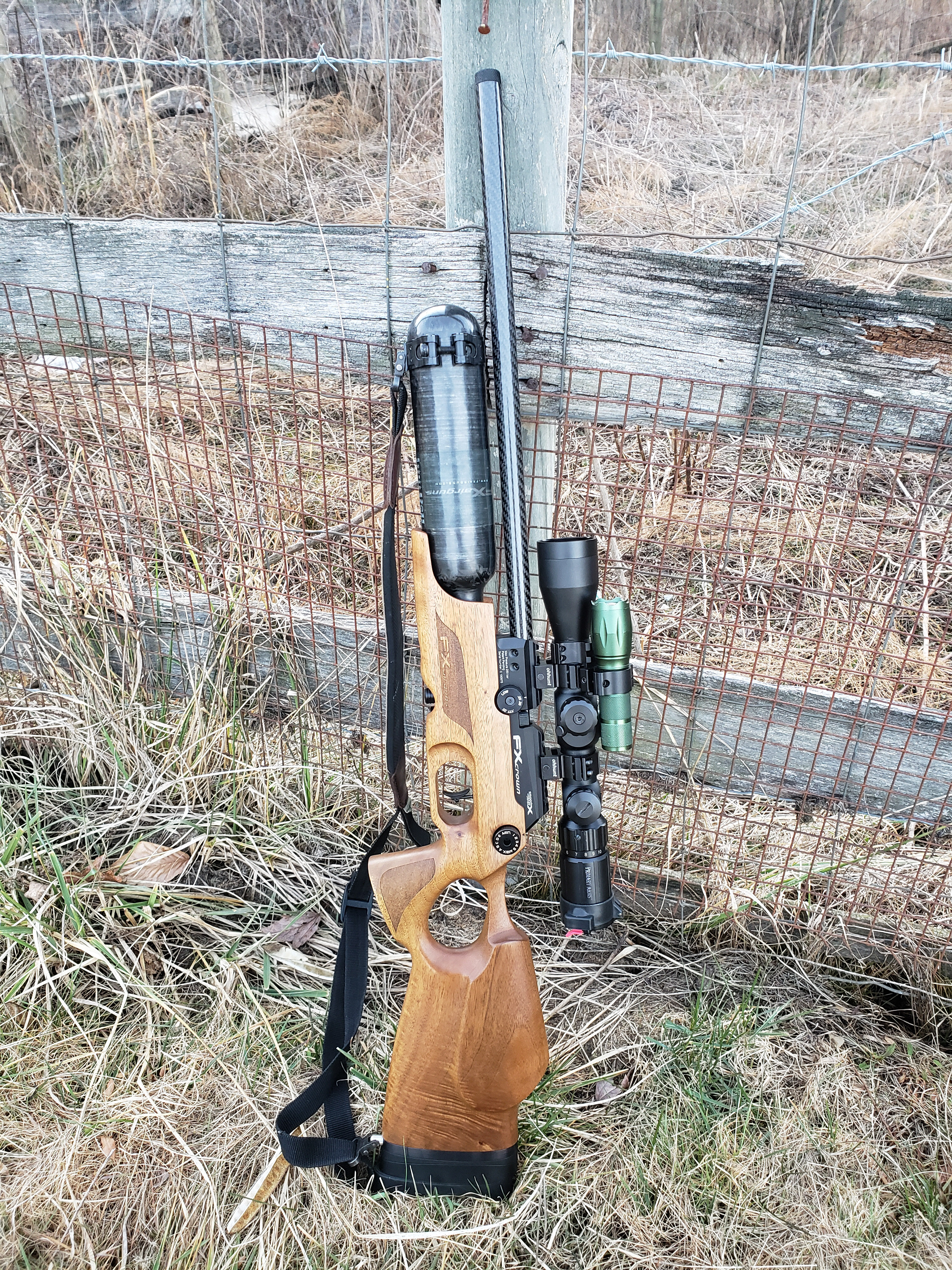

I think you'll love the 500mm barrel. I had to get my hands on one when the superior liners came out. I bonded the carbon reinforcing tube to mine, and it's really not picky with any ammo I've put thru it. The shorter the barrel, the less it is affected by harmonics, and the less dwell time the projectile has. Plus they are easier to maneuver in the brush.

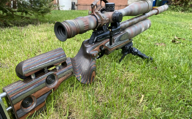

So my 380mm 22 crown shoots the JSB 18’s at 880, but it also loves the H&N 21 grain slugs at 875. No need to change barrels. I just change the transfer port wheel from 177/22 (pellets) to the 25/30 and I am shooting slugs. super accurate both ways.
I own 3 crowns, compete with a 25 in EFT and bench rest and’ a 177 for FT.
