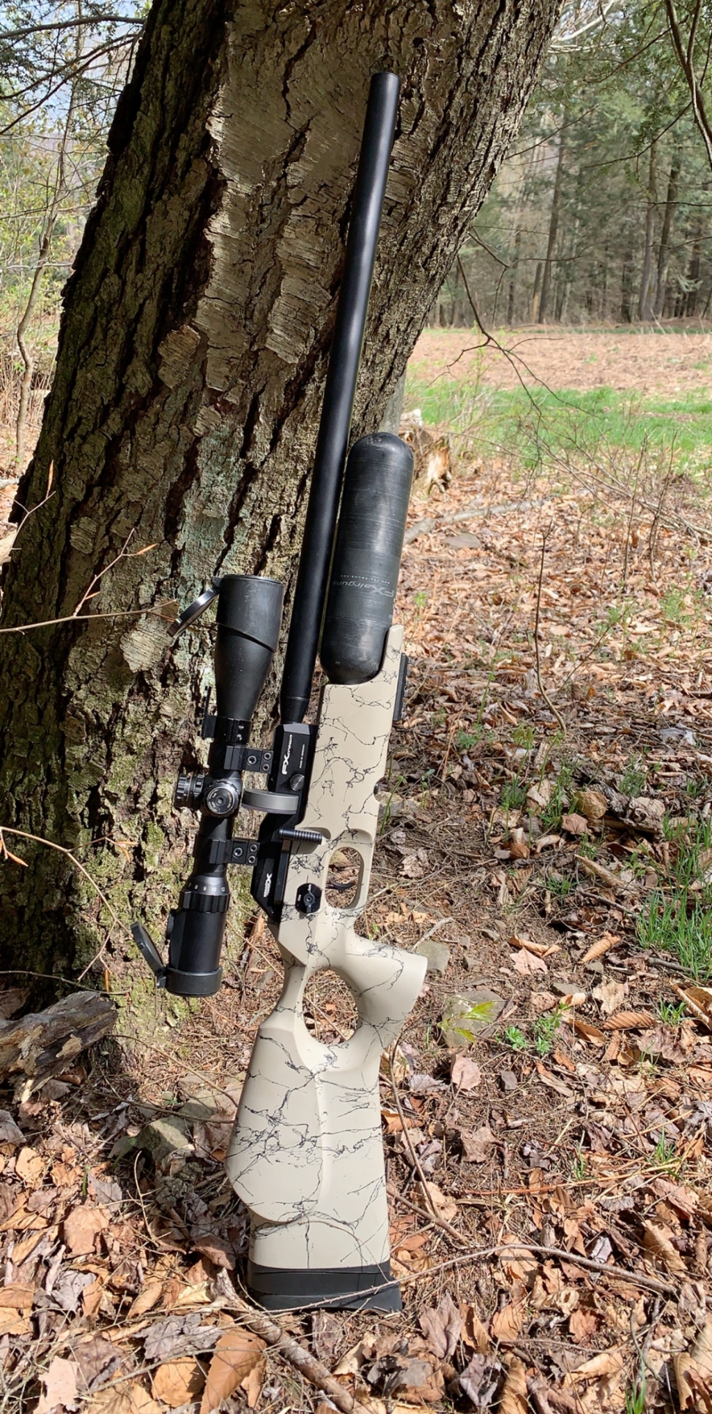

Hi guys, first time posting on here. So I recently got an Fx crown from Utah Airguns. I got the synthetic .25 and had them hydro dip the stock. It looks fantastic. But I’m having a little trouble getting it to shoot the way I’ve seen these rifles shoot.
I’ve cleaned the barrel to the point where patches come out perfectly white. The regulator is just a hair under 140 Bar according to the gauge. I’ve tried Max, 5, and 4 on the power wheel and my groups really aren’t under an inch at 50 yards. I keep getting random fliers too. It could be a bad pellet here and there but I look them over before loading and they usually look ok. I’m a pretty good shooter. I have centerfire rifles and have shot since I was a kid (21 years old now).
The gun definitely shoots better than any airgun I’ve shot in the past, but doesn’t do as well as I’ve seen an Fx crown shoot. Any help would be greatly appreciated!

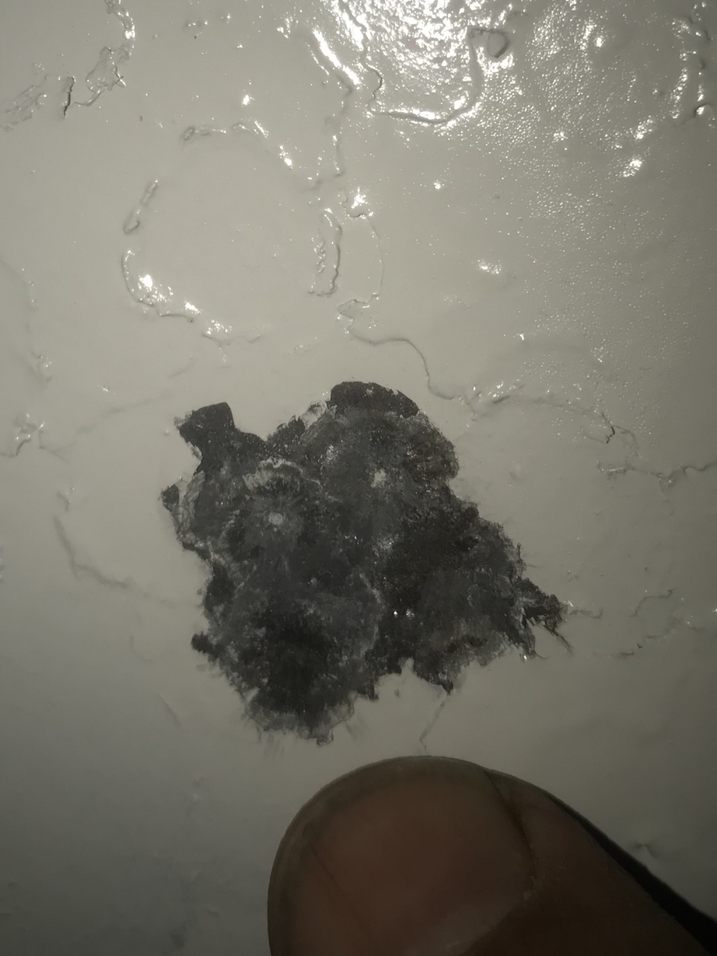

1556592043_14537732505cc7b5abcccd01.92681254_4F68FE88-5A31-428B-BD2E-B3121C92C54F.jpeg
Mine is best straight after cleaning. Also I polish all my liners and they all improved after. I shoot the 25g a little slower at around 870fps
This is my best 5 shot group at 100y but if it’s calm and I have good pellets it usually around 1 inch. I tune as per Ted which specially for the 25g so a bit lower on the reg pressure also at just over 130b
