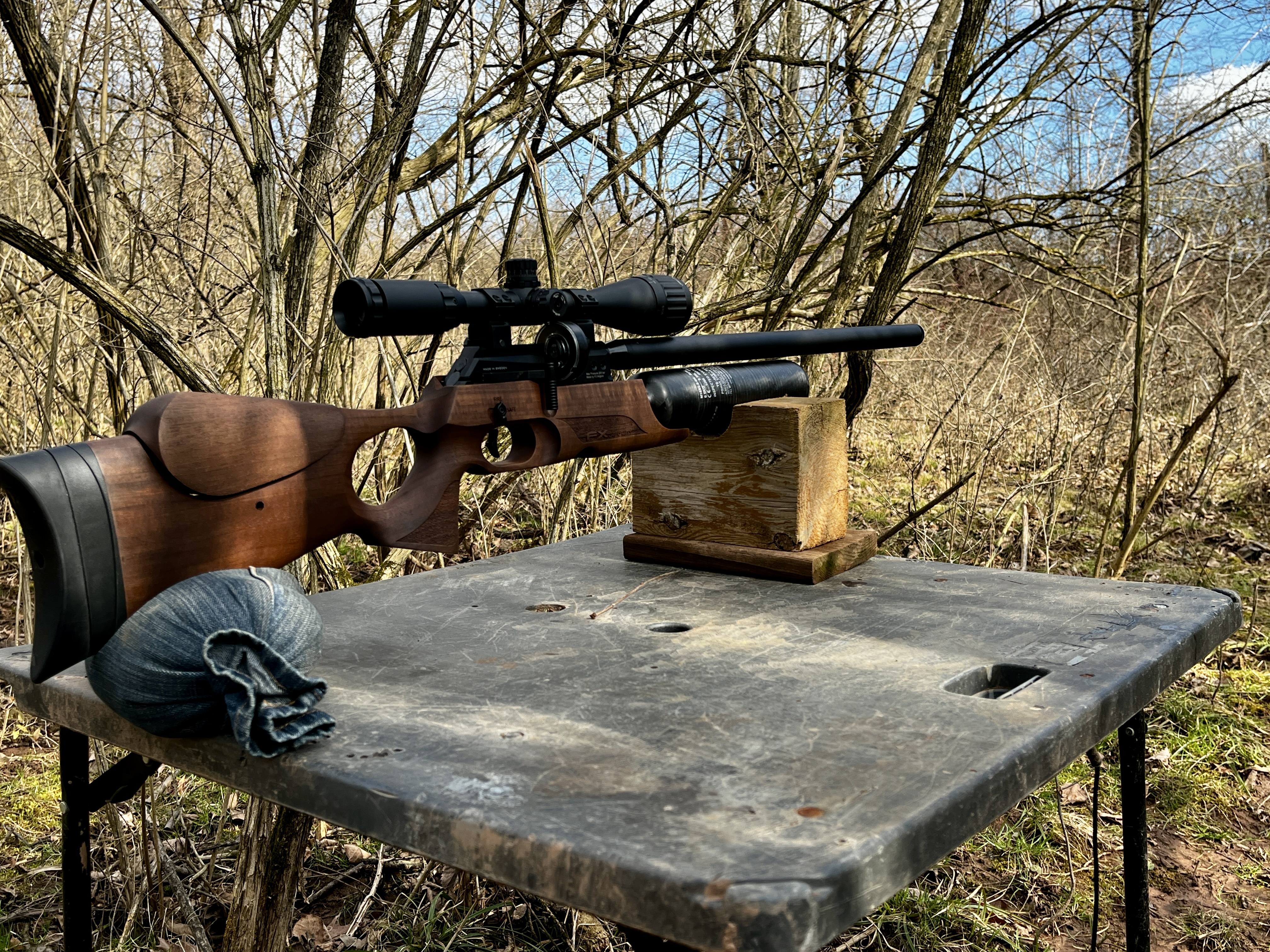

Here is the 30 cal slug tuning report.
If you want spec of my gun, reed my first post, its all there.

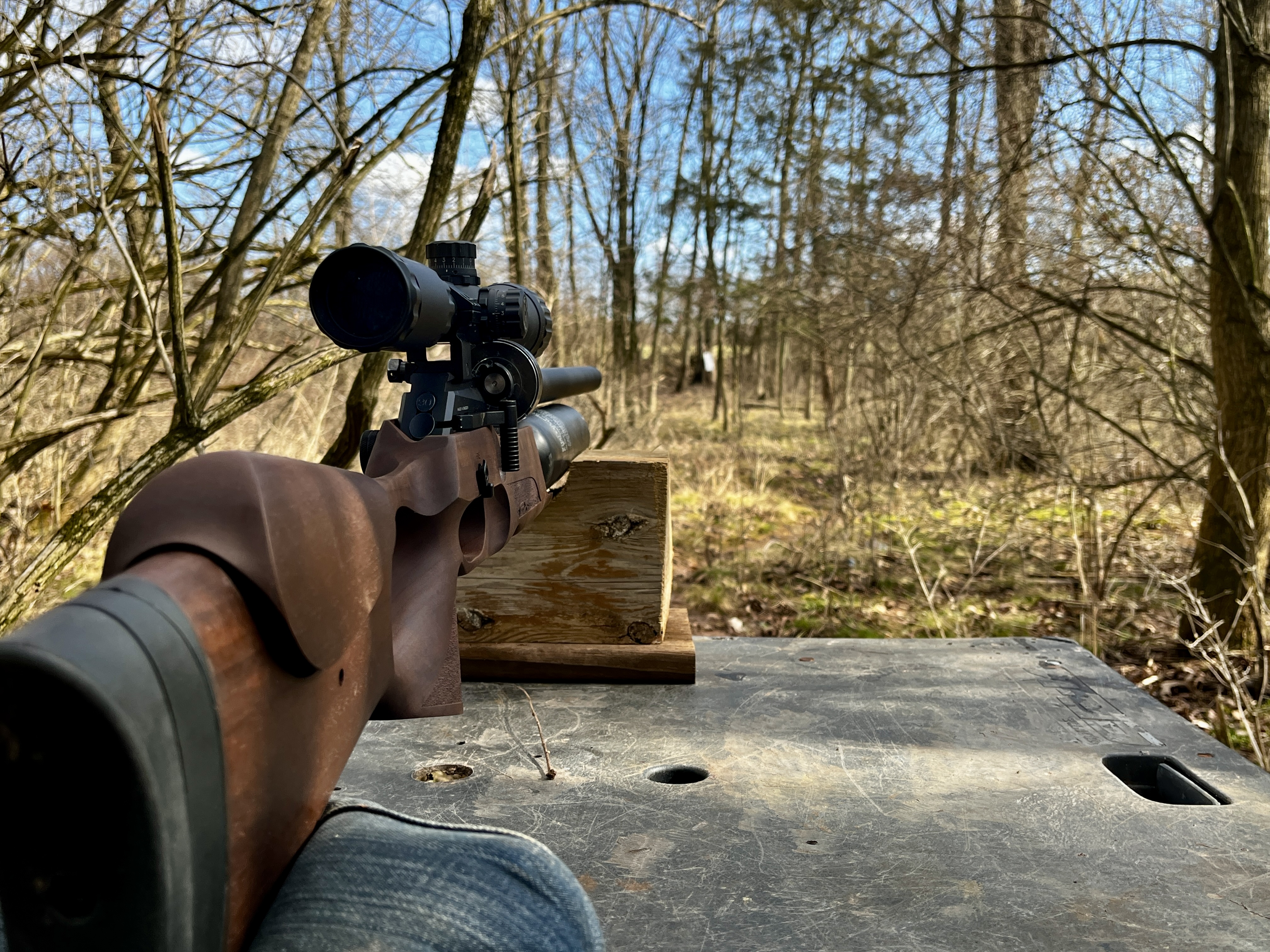

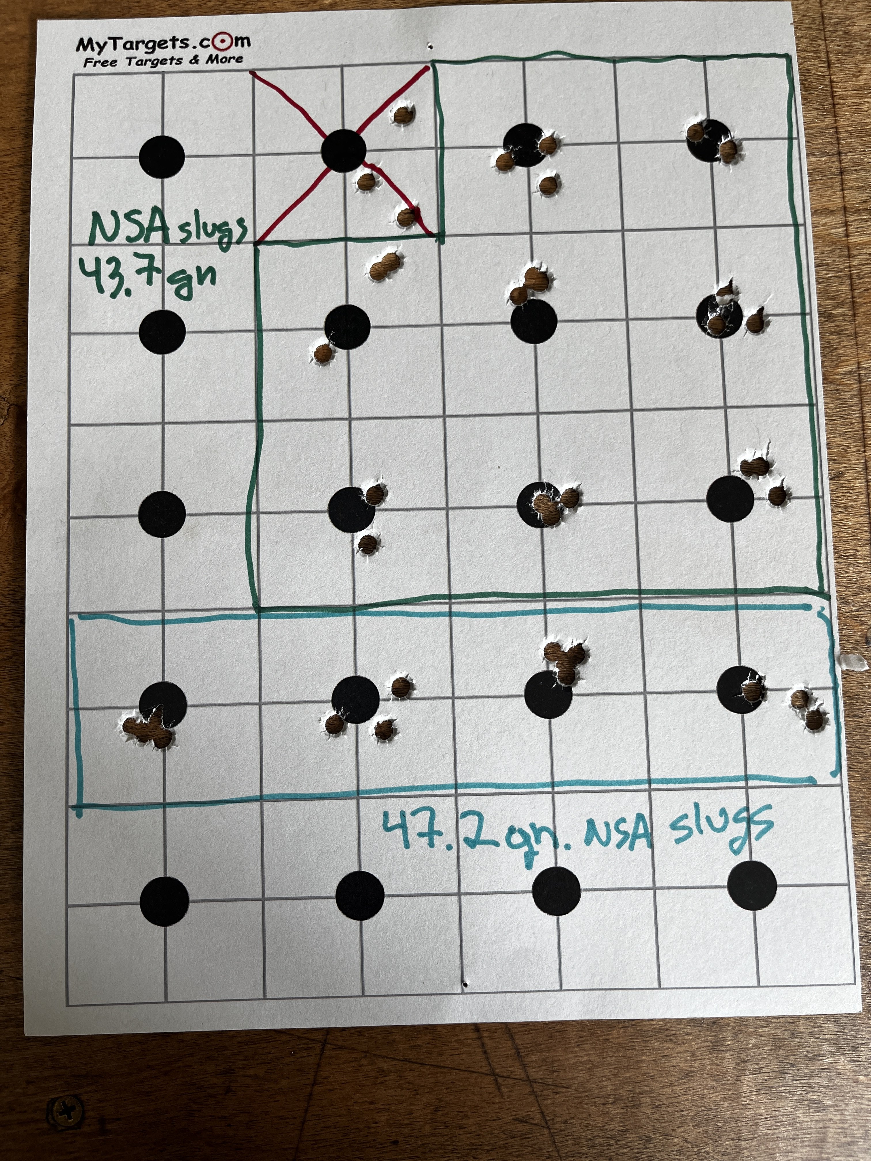

5. Here are the results. Gun shut awesome (see pictures below) I shot 3 shot groups with 44gn NSA slugs and 47gn NSA slugs. ignore red X group, that was me zeroing. Top 8 groups are 43gn and bottom row of 4, 47, seems like 43 did slightly better.
I shot this at 50 yard.
I consider this a huge improvement over all, same time I shot off of the bag, so there is some human factor, I am sure if I put my gun on the stand I can get better results.
