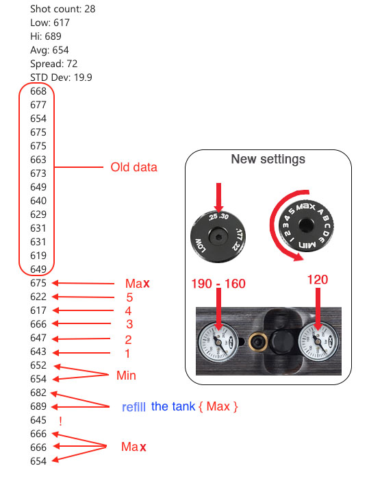

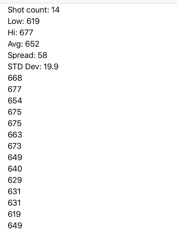

I have a problem with my new rifle crown , I bought it around a year ago and can't use it until a few days ago I bought a A FX chronograph and when I record the speed of the Pallet it couldn't give me more than 675 fps in 18 gran JSB with 140 bar for the chamber ,,,,
so where is my problem ?
regulator !
lack in some where O rings !
or what ?
I try to increase the humor tension by using the 1.5 Alan-key and try 12 shots as :

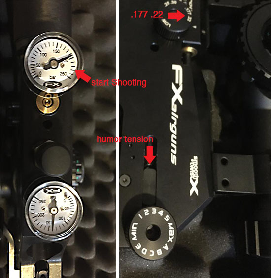

the Rifle pressure is almost 240 -230
and the speed as the 15 shots in the pic every shot with 1/2 turn on the hammer spring adjustable ,,
so if it mixed out what you suggest >

Turn the transfer port wheel to .25-30 cal. for more air flow for starters. Did you increase the hammer spring tension with the 1.5mm allen key? To adjust, keep turning the hammer spring pre-load until the power wheel will barely turn and then back it off a little. With that set properly you shouldn't need your reg. at 140 either. Once the hammer spring is maxed out and the port opened to .25-30 cal. you should get way more velocity, you can then back off the regulator and hammer spring and tune your gun for accuracy. Give it a try.

Hi Mr.Stoti , I already do that - " keep turning the hammer spring pre-load until the power wheel will barely turn " I start with it but I keep the transfer port wheel to .177-22 cal and I didn't play with the reg. at 140 .
I only move it once on the shot No.8 and I realize it only give me about 24 fps ( from 649 to 673 fps) , but the problem I am at (247 fps) out of speed because the FX say that at 16 gran on .22 barrel it should give me around 920 fps .
I do the same steps as :: Meathead Marksman as "FX Crown Harmonic Tuning Guide" on you tube ::

130 bar is about the sweet spot... BUT you shouldnt really be losing much of anything at 140 bar.... How fast does the gun sound/feel/look like it's shooting? Do you have other guns to confirm the chrony is reading accurately?
I cant help but think your regulator is either set much higher or much lower than its reading? Regardless of hammer spring tension, with the transfer port open, you should be getting some pretty decent fps. Higher than you are seeing.

so I take off the air bottle and tack some shots to empty the air inside the gun and the reg .. and follow the procedure to set it to 120 bar,
The strange thing ,, after I tack off the bottle the reg Pressure is go to ( 0 ) !!! but I tack some shots just to be shore there is no air in side the Gun.
then I tacke some shots as follow at the same Humor sittings before ,, just play with the humor wheel :::
So where is the problem ?
