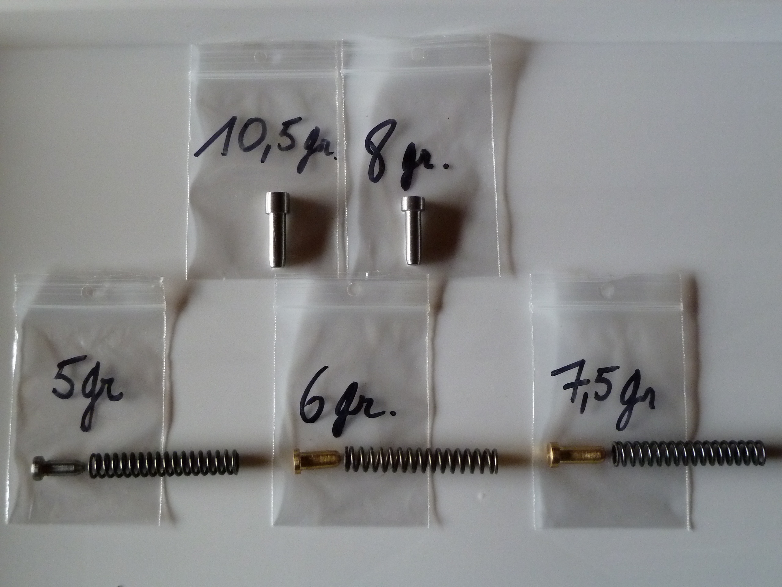

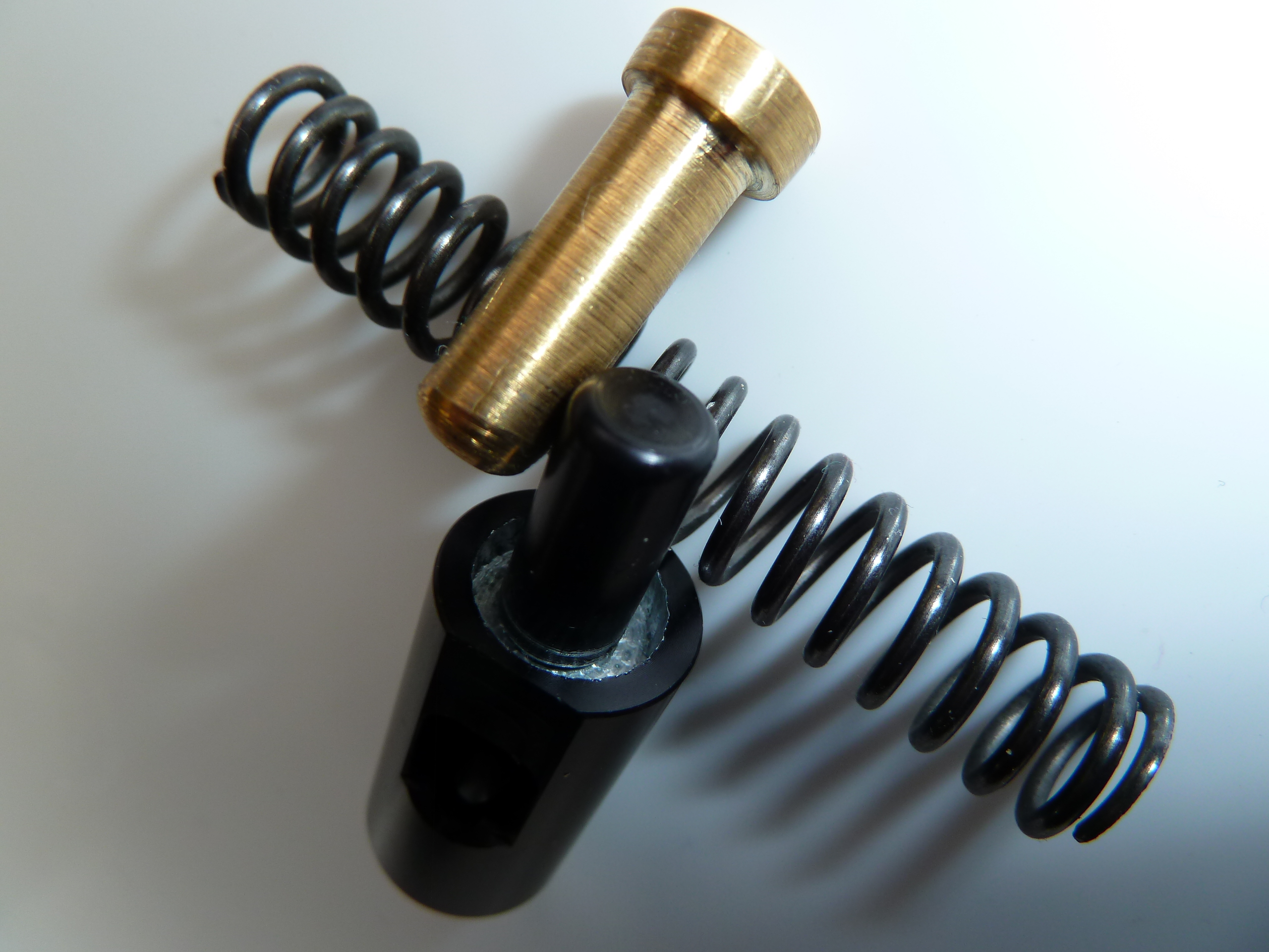

      Purchasing hammer weights is an option. I ve done so myself once. Originally bought the 6 gram weighing FX 20271 intended for use in my Crown.
      But... since i wanted a somewhat smaller/shorter 6 gram weight (to combine with a Huma spring) , i made my own. For this particular purpose i chose brass because of its volumetric mass density being somewhat higher than in steel.
      So ... why not consider making some weights yourself, specifically to suit your own needs. Not at all that difficult, even if you re not technically schooled (like me).
