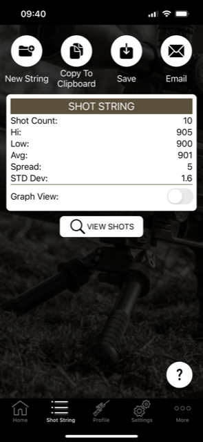

Sounds like you are already getting dialed in but I’ll throw out my recent experience. I am tuning a Crown MK2 .177 600mm. My primary goal is a great tune for the 10.34 pellet. Depending on velocity I have found that the FX, JSB and AA branded pellets all do very well. They are all great in the 860-885 range. In my rifle they do not seem to like going over 900 fps. My secondary goal was to shoot 12-13 grain slugs without having to make a lot of major changes. I am getting very close to that tune.
With a reg setting of 125, front transfer port wheel to medium, and using a power wheel from Mont here on our forum I have found multiple hammer spring settings that will push the 10.34s to that great range of 860-885fps. Then, all I have to do is turn the transfer port wheel to high, go up a few clicks on Mont‘s power wheel and I’m shooting the NSA 12.5 grain slug at 940fps. So far the accuracy with the various 10.34 pellets is outstanding at 50 yards. The NSA slug setting is also very good but not as great as the pellets yet. But, I have only just begun my testing and I’m confident I’ll find that perfect setting.

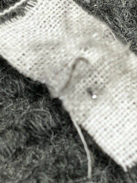

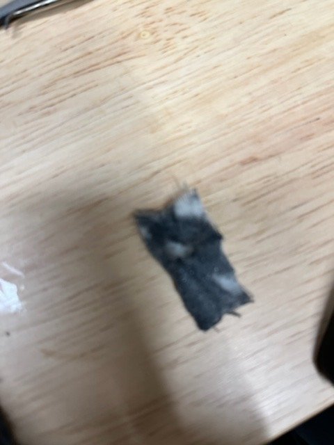

Well after getting beat by the wife in 2 FT matches by double digits (We are usually 1-3 points apart) the inner tweaker took over. So I pulled the barrel for a good cleaning before I switch the rifle over to the 10.34’s. What a nasty mess, with even a “chunk” of lead after brass brushing it.
View attachment 331896View attachment 331897View attachment 331898

Tony please let us know what setting you wind up using and results. The view shot string above shows some really good values (y)
