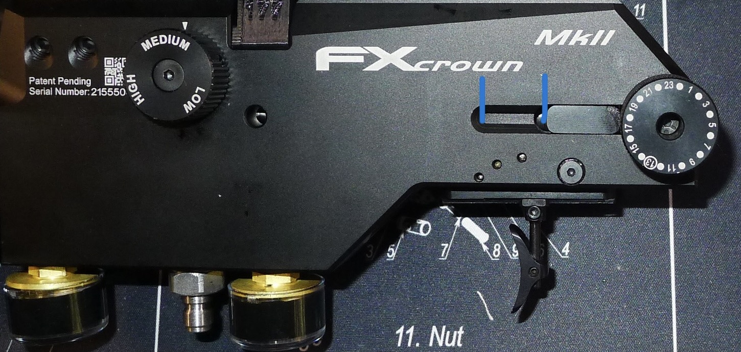

Without the new micro preload adjuster everyone's HS preload is different so there is no way to repeatably replicate a tune between guns. Best and easiest thing to do is simply reduce your hammer spring, you will likely need a newer style power wheel with more finer steps between PW settings.
qball
We can actually measure, with repeatability, the hammer preload on the Crown Mk2. E. Rowe has an older video showing how to do it with a caliper on an Impact. Once you get your best setting for a given pellet you measure the distance of the opening with the slider against the hammer adjuster wheel. The new micro adjuster on an Impact Mk3 is essentially doing the same thing without the need for a caliper. See attached picture.
Frank
qball
Frank
Yes you can measure it but everyone’s caliper and or measuring angle is slightly different, it’s quite small and even tiny bit 1/100 inch off speed if different. Then, regulator reading is a suggestion/range. If stars align then you can be close but unlikely if you apply my Crown’s FT settings you will get exact same speed as my gun or even within 15-20 fps. Then how do you replicate a gun’s harmonic from one gun to another? There is no adjustment for that. Even on the impact with micro adjuster preload is still a range, not everyone’s C1 is within 1/100th of an inch from the end of the Rod. Lighter the ammo and lower the power larger the margins of error or larger the effect of 1/100 inch difference in preload makes.
Moral of the story is learn to fine tune your gun because no settings can be replicated exactly, think of other people’s settings as good starting points.
Reactions: 0akhonor
qball
I agree that any measurement will only apply to the gun they are made on and depend on measuring accuracy. The issue I had with your initial comment is that the Crown micro hammer adjustment wasn't as measurable as the new micro preload adjuster. Both are valid but may be misleading for another person's airgun as you have just pointed out.
The advantage of sharing measurement data is that it may get somebody else into the ball park for the same configuration thus reducing the time and effort in tuning their airgun. The key is not to take the information as an absolute.
I have a problem with determining a good regulator starting point therefore I will ask for help. You provided me with a good starting point for my new Crown/pellet combination. I took that as a good starting point and got to a good initial tune faster than me just guessing at a starting pressure (thank you).
Frank
  • Love
Reactions: qball and ThomasT
qball
Frank
