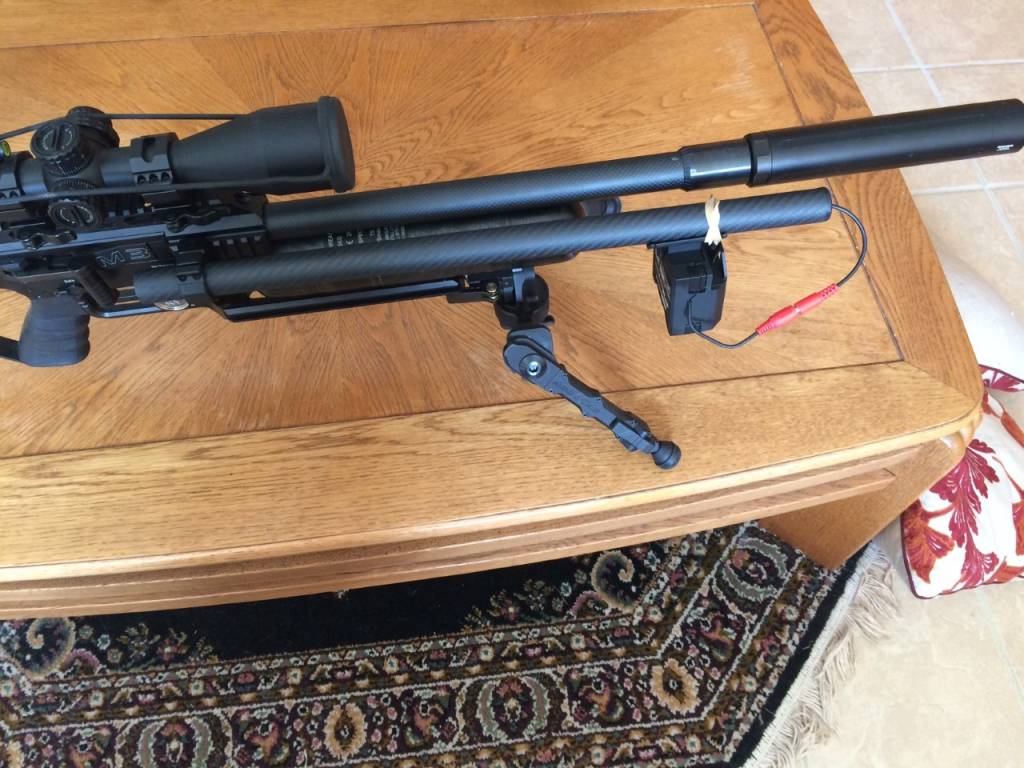

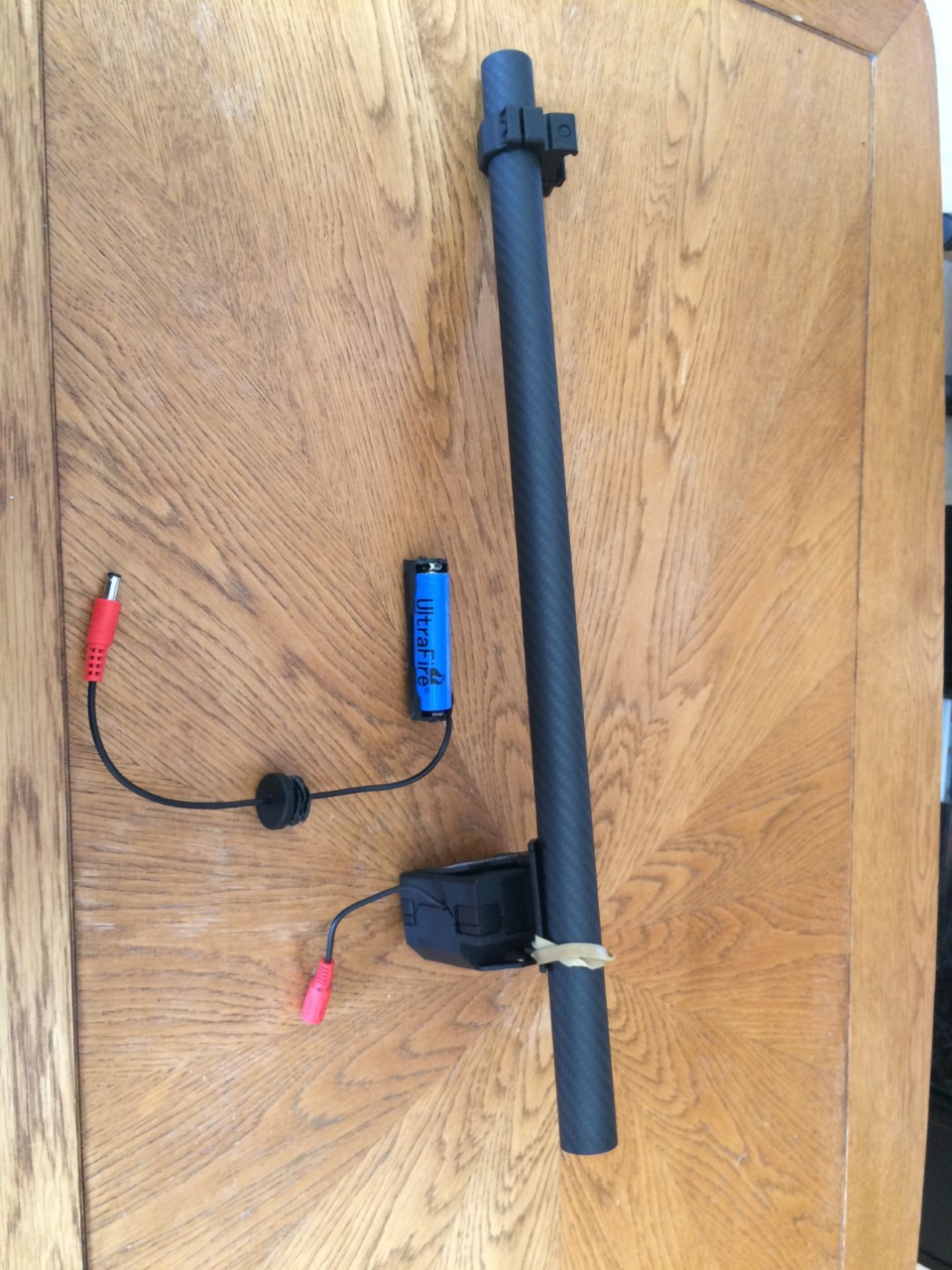

I decided to buy the FX chrony because tuning my Mrod and Impact M3 I felt I was just wasting lead shooting through my F1 chrony.. With the FX chrony I installed it on a CF tube and mounted it to the side rail on my M3. I have a teryx stock on my Mrod so I can use the rail on the bottom. This way I will not be changing my POI when taking it on and off and can tune for speed and accuracy at the same time or at least thats the plan.
I have a 18650 battery slot sanded down to slide into the tube. These batteries are 3.7 volt lit-ion and charge to 4.2 volts. My FX chrony draws about 14 ma before it connects and 82 ma. when connected. I ran it connected for over 4 1/2 hours continuous on just one battery but that was without shooting through and im guessing it draws more as it reads a projectile. Its winter in MN and I will not be able to shoot till spring.
I am curious if anyone knows the current draw under normal shooting conditions and how long a set of AAA batteries last you. I can always add another battery in the tube.
Have a look any input welcome

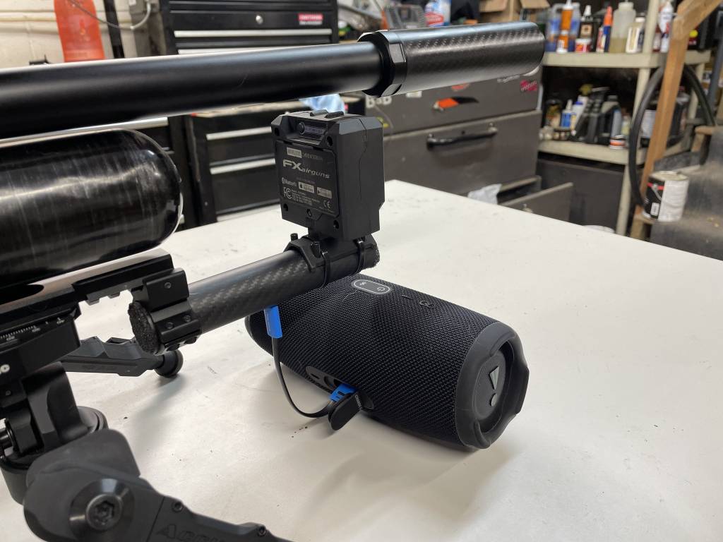

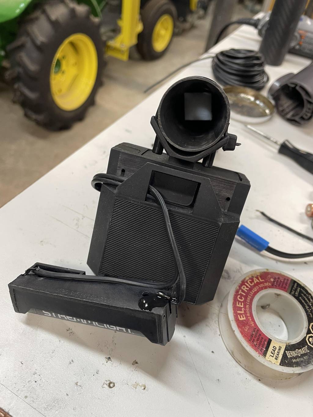

Hey thanks for the inspiration Rimshot. I thought your idea was so good I decided to do something similar. I just got tired of changing and making sure I had batteries on hand for my FX chrony. So this is basically what I did.

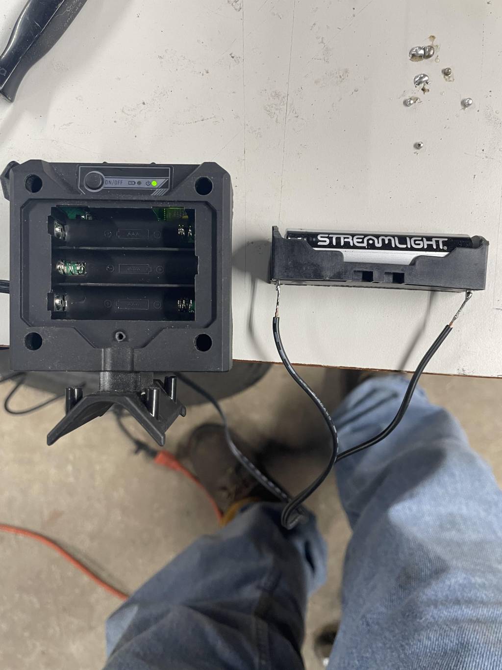

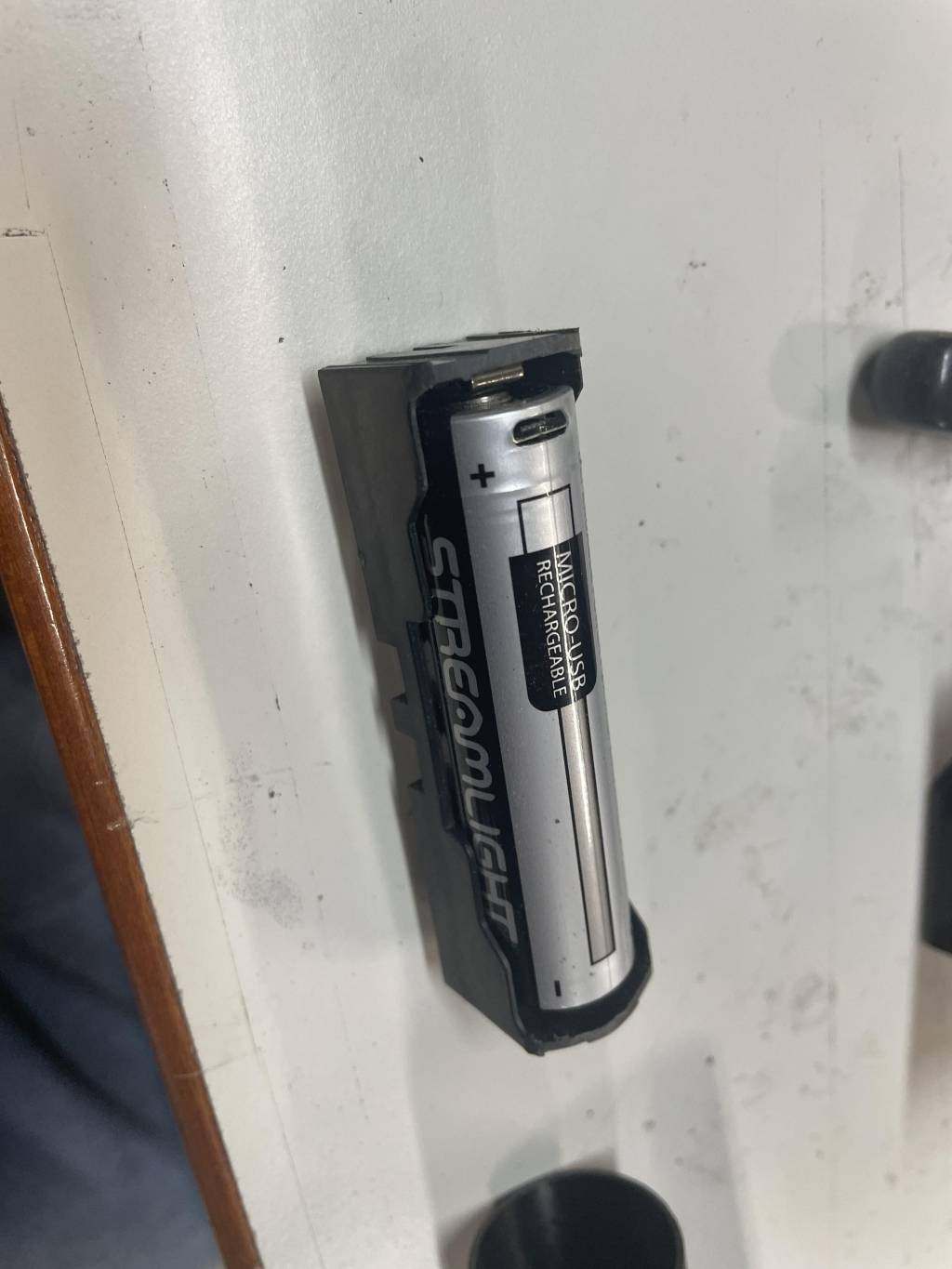

I used a Streamlight USB rechargeable 18650 battery (2600 mah 5amp) and put it in a battery sled. Sanded the corners so it would fit in my 30mm tube.
Carefully took the chrony apart and figured out which leeds to solder to.

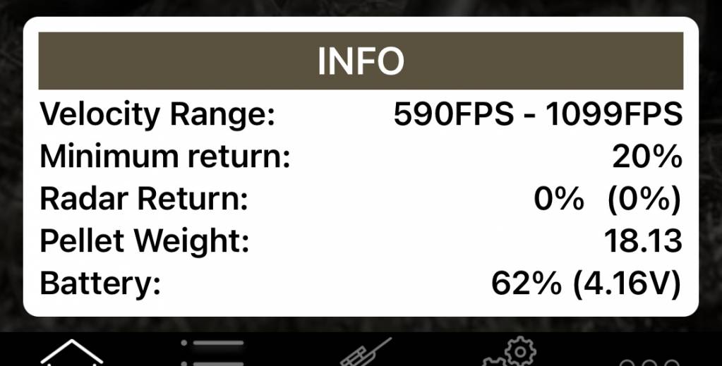

Powered it up to make sure it works. 4.16v is the max that this battery will charge up to. It is a couple of years old and was used in a high output flashlight.
Figured out how I was going to route the wire and soldered it up. I also used a plastic block as a backstop. Once I figured out the length of that block I could guess where to dremel the hole for the mini USB port. Then I hot glued the block so the battery would line up.
Time to mount it up and try it out! Thanks again for the the inspiration!

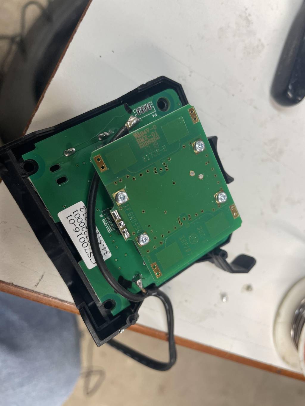

Ok I installed the voltage converter and heres what I found. With the 18650 battery at 3.9 volts the current draw without the converter was .085 ma. With the converter in the circuit the output voltage increased to 5 volts and the current draw increased to .230 ma. The current draw was basically nothing until the chrony was wired in.
So what does it all mean? Its a current hog and your better off without it.

I was able to use my sent up over the weekend. Three different shooting sessions over three days.. My FX Boss, Impact .30 cal M3 sniper, and .22 Marauder. Over 4 hours of total run time and more than 250 rounds and not one missed shot. I did have one shot register that I didnt shoot that was about 200 fps slower than the others. I have the minimum return set on 20% for what thats worth. I did not have to recharge the battery still reads over 4 volts but I did have to recharge my Iphone 5S.
