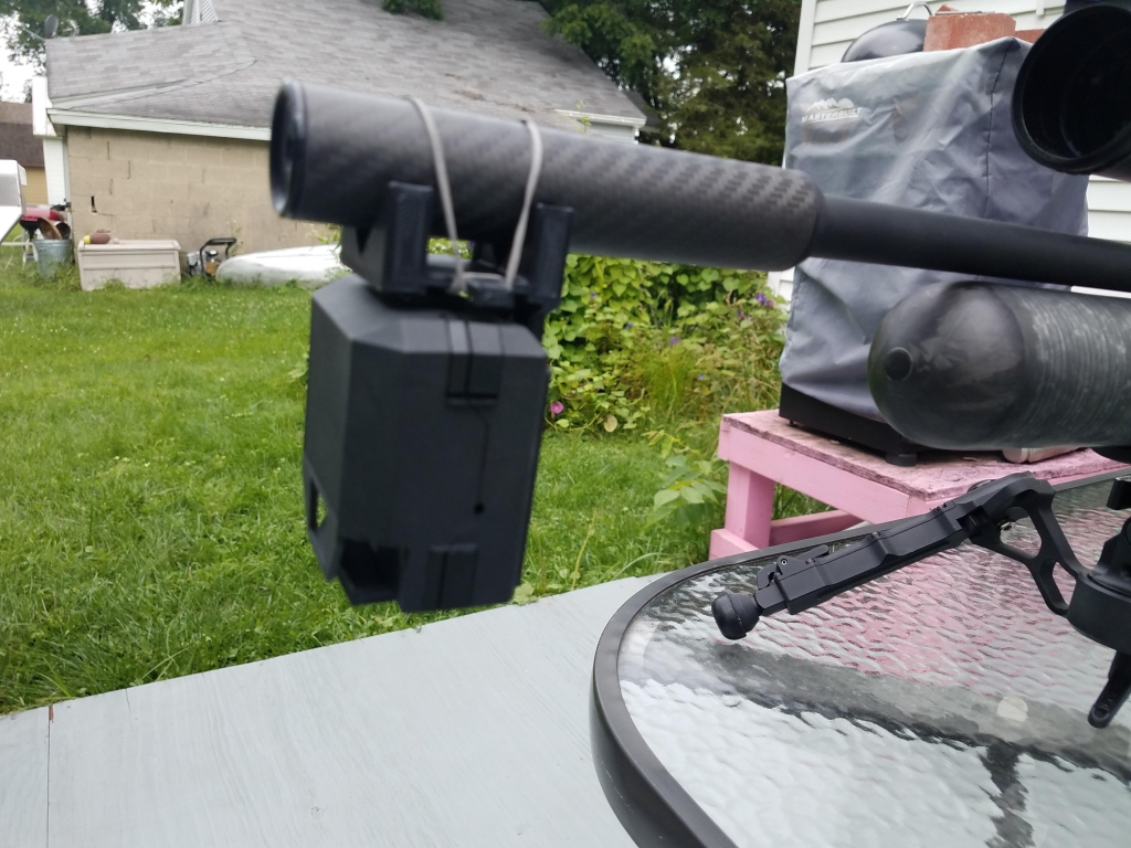

I also got the 3D printed barrel mount for it today as well.

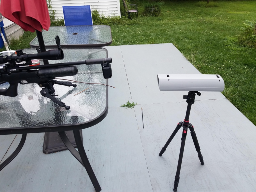

I'll get my optical out and see how it they compare soon as Snake gets here so theres a phone for each device, then I'll report back.
The mounting device works, it was from Steve Allen in the UK.
I think it's over priced compared to the gopro mounts that are available, but theres no messing about with this one. I'll speak more to changes I'd like to see later.
I probably should have used a rear bag to minimize the variation that the optical scanner might pick up.

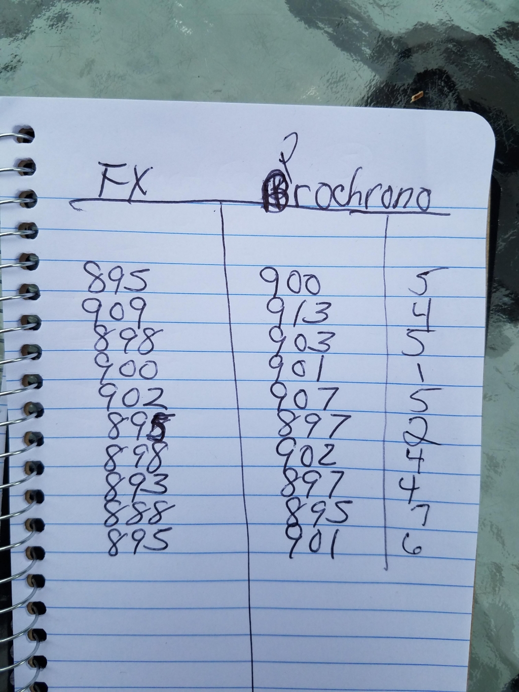

I'll do all that at some point, but today's excersize was to see if things had changed from the previous version of the app, as well as to get a rough idea of its accuracy apropos the optical.
I'm very pleased I can use it on my short range now, although that may have been fixed with the barrel mount. The difference of 4.3 fps average might be explained by the position of the FX chrono on the barrel, the distance to the ProChrono optical, as well as the angle changes of the gun affecting the optical.
What I did find odd was that the ProChrono was always reporting a faster speed even tho it was out a foot or so from the barrel. I kinda thought it should have been oposite that.
In PerkyVal's test above, the velocity difference can't be attributed to the distance of the Prochrono since it is further away (velocity would be lower if anything and the readings are all slightly higher from the Prochrono). The difference doesn't look to be large enough to be a concern at all and who knows which would actually be "accurate" between the two anyway? I do notice that there aren't as many "same readings" as mmahoney was getting for the FX. Nice test. Looks like things are improving with the FX. Thanks to all who have worked on this. I think I'll get one.

Didn't consider that. Good thought. Another thing to consider-you know WHERE the Prochrono is measuring but not WHERE the FX is measuring. Maybe this is why the position as noted by CC and others seems to be relatively critical. More knowledgeable folks will have to answer this but there must be a "CONE" of the radar going out the front, narrow near the face of the unit and spreading out. How divergent is that cone? How far out does it disperse to a non readable level in a battery operated unit? Would be interesting to know.

At the bottom of the setup screen you will now see a calibration setting. You can increase or decrease your velocity readings by up to 2% if you feel the results are reading a bit slow. Your data looks pretty close, so to calibrate it to your other chrony you should only need to bump the value up about .4%
